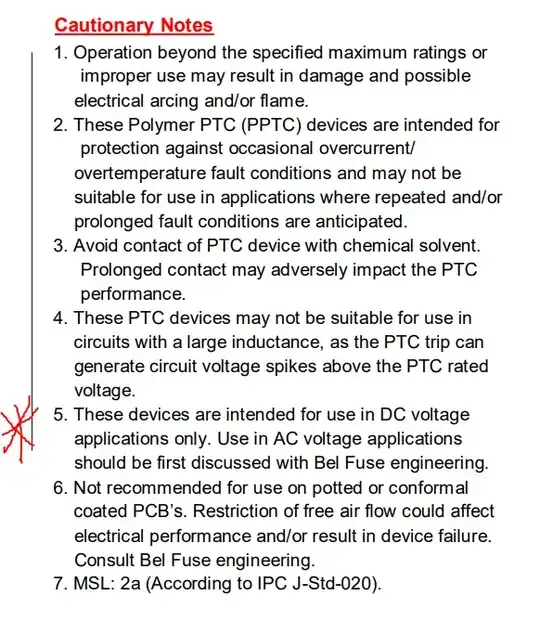

Why is it that surface mount (SMT) PTC fuses can only be used on DC lines but through-hole PTC fuses can be used for both AC and DC?
This came from a cautionary note on one of Bel Fuse's PTC application note documents.
Page 3: BelFuseNotSuitableForAC
This turns out to be a better question than it appeared to be at first :-).
The added reference to the Bel 0ZCM PPTC datasheet show that they do indicate that AC use is not appropriate for at least the 0ZCM series devices.

  • Bel Fuse says AC use is not a good idea

Consideration of the method by which PPTCs operate and a (brief) resurvey of the various application documents does not suggest any fundamental mechanism which makes AC less applicable than DC. However, one can imagine various mechanisms which are potentially specific to a manufacturing process or device characteristic which may differ between AC and DC. For example only, the thermal time constants of PPTC devices as a whole device are large compared to AC mains cycle times. However, as current in a PPTC device will vary cyclically at AC frequency it is possible that micro-heating occurs at boundaries between conductive particles in the polymer matrix and that peak AC voltages thus may cause substantially more heating at the particle boundaries.
As the datasheet is dated May 2019 (and the questioon was posted in August 2019) it is likely that Bel would be happy for you to take up their invitation - " ... Use in AC voltage applications should be first discussed with Bel Fuse engineering."
