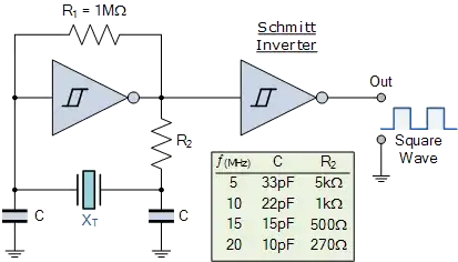

(Example circuit from the above link - Note additional comments below.)
Another group of crystal oscillator examples using other gates and op-amps.

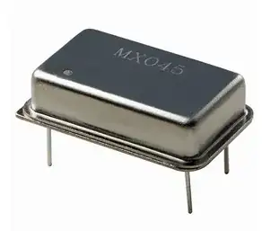

However, you did mention hooking up the +/- pins, which would seem to indicate you might have an oscillator module, more often with 4 pins, possibly similar to this: enter image description here
(Picture from Mouser ),
with a datasheet here.
In that case you basically can (per the datasheet spec's) hook it up to a 5V supply and generate a high frequency output.

    The tutorial may be good but that picture is just wrong and against the text it has. The first inverter connected to the crystal would never work if it is a Schmitt trigger like in the picture, as it can't be biased in the middle of it's linear operating region, as it is not linear. – Justme Oct 02 '23 at 06:30
  • @Justme - While I cannot vouch for the linked article using Schmitt trigger gates with crystals, the CD4049 inverter (one of the 3 listed) does simulate well at relatively high frequencies. Oscillators with Schmitt trigger inverters would make more sense using lower frequency RC oscillator circuits. – Nedd Oct 02 '23 at 07:08
    Yes any unbuffered CMOS inverter should work in that cicuit. Emphasis on both CMOS and unbuffered. CD4049U at least. The CD40106 is a schmitt trigger and I can't even find any reference to a 74HC19 existing, but a TTL 74LS19 does, and is also a schmitt trigger. – Justme Oct 02 '23 at 07:33

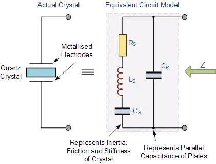

The equivalent circuit for a crystal has a series capacitor, inductor and resistance, and a parallel capacitor.
Depending on the oscillator, either the series or parallel mode can be excited.
Have a look at electronics-tutorials.ws (where the diagrams comes from) for an excellent, and detailed analysis. This page also includes a very simple CMOS inverter oscillator circuit (which is referenced in one of the other answers).

  • Ok so it's exactly like a LC Tank circuit. If I connect my crystal directly to DC it will flex once and will emit a single RF (which is hard to detect) but If I turn the DC on and off very quickly the crystal will flex continuously and and keeps emitting the RF. We are just replacing a capacitor-inductor (the tank circuit) with a single crystal. Is that correct? – Dan Oct 02 '23 at 13:01
    The LC comparison is spot on, though the actual equivalent circuit is LCsR-Cp (with series and parallel resonances). Have a look at this link https://www.electronics-tutorials.ws/oscillator/crystal.html which talks about the equivalent LCsR-Cp circuit for a crystal, and the series and parallel resonances (where the series resonance is what is normally used). Also look at the CMOS oscillator example, which gives a very easy way to drive a crystal. – colintd Oct 02 '23 at 13:38
