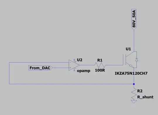

I want to make a dummy load using IGBT. Is it possible to control the Ice (collector to emitter current) using the gate voltage? It would be really great if it is possible to explain the answer. The following are the parameters.
Voltage and current need to be controlled: 85V 50A ( I want to control the current from 0A to 50A as required by the application).
Gate voltage: Anything which IGBT requires. Following is a sample circuit only. enter image description here

    Have you chosen or ear-marked an appropriate IGBT yet? You should post a general circuit idea showing what the load is and how it is connected. You should also explain what other DC power rails can be made available and what level of control accuracy you need. – Andy aka Sep 26 '23 at 13:33

  • @Andyaka Yes, IKZA75N120CH7 this one. – Nithin Sep 26 '23 at 14:21
    That device cannot do what you want. See the reasons in my answer that I have added and compare the device you stated with the types of graph added to my answer. They haven't even shown a safe operating area graph in that device's data sheet because they don't want you using this in linear applications. Also look at the typical transfer characteristic graph in your device = it will fail in milliseconds. – Andy aka Sep 26 '23 at 16:42

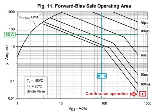

If it's a dummy load, your power dissipation is going to be 85 volts × 50 amps = 4250 watts. That's 4 times greater than what I stated earlier. If you insist on going down the IGBT route here's the type of problem you could easily face that can leave you with dead devices and a lot of head scratching. Consider the IXXN200N60C3H1 from IXYS just as a quick example of something that you might come across. It has decent enough ratings: -
However, the devil is in the detail such as this graph: -
I've added the coloured lines and text. As you can see, at 85 volts and 50 amps, you cannot operate the device for any longer than about 3 or 4 ms. In other words, not much of a dummy load for continuous operation.

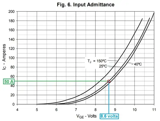

But it does get worse than that regarding the control of the gate voltage and collector current; if your 85 volt supply is capable of delivering hundreds of amps, using an IGBT like this (intended for switching applications) but in a linear application then you run foul of thermal runaway. Look at this graph: -
At 25° C you nominally need to drive the gate with about 8.6 volts (with respect to emitter) to achieve 50 amps collector current. Then, as the device inevitably rises in temperature (very, very quickly on the die of the device) the current can rise to 70 amps in a few milli-seconds and, unless your feedback circuit is very, very quick at responding, you'll end up with a dead device in maybe less than 20 milli-seconds. The problem here is that the body of the IGBT won't even feel warm to the touch and, no amount of heatsinking would have saved the day.

  • Actually, I want to make a dummy load. Input is 80V and 50A, and I want to dissipate the current I wish. i.e some time 10A , sometime 15A etc.. I've added a sample circuit for clarity. – Nithin Sep 26 '23 at 14:24
