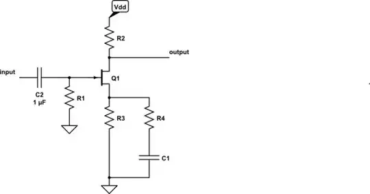

You typically wouldn't be using a VGS = 0 if you use a source resistor. Adjust the source resistor value to the desired drain current. You can use load lines to figure out the value just like the old vacuum tube days, or, figure this out empirically (use a variable resistor in place of R3).
schematic
R1, gate bias resistor, can be some high valued resistor, perhaps 1 MEG.
R3 is used to set the drain current.
If using as an amplifier, you'll probably need R4 & C1 to set the gain along with R2.
If making a source follower (gain slightly less than one), get rid of R2, R4, and C1.

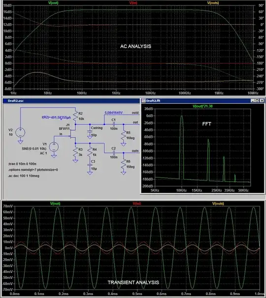

In response to Lexor's comment below, you can probably make this work with a BFW11 JFET. I added a Spice model in LTspice's standard.jft library to simulate this in LTspice. I have no idea about the model's accuracy, thus, view the simulation with suspicion.
.MODEL BFW11 NJF(VTO=-2.0850 BETA=1.24635m BETATCE=-0.5 LAMBDA=2.46045E-2 RD=1.68159E1 RS=1.68159E1 CGS=2.25000p CGD=2.25000p PB=9.32203E-1 IS=2.16894E-16 XTI=3 AF=1 FC=0.5 N=1 NR=2 MFG=PHILIPS)
The simulation shows a drain current of 492 uA with a 3k source resistor. The value of R3 was empirically determined which took about four tries.
If used as an amplifier (output taken at V(out)) the second harmonic is down 65 dB with a 10 mVp input as shown in the FFT. At 100 mVp input, the second harmonic is down slightly better than 40 dB. Note, the FFT was performed using a stop time of 100 ms in the transient analysis.
If you use this circuit in a source follower configuration, you can probably drive a 1 or 2 meter cable. If the output is taken from the drain, you will need a buffer due to the high impedance of the output node. You can use a source follower as a buffer with very little penalty in noise performance (I have found that JFETs used as a source follower are inherently low-noise).

  • Would my jfet BFW11 be able tk work though? – LEXOR AI Sep 23 '23 at 09:57
  • @LEXORAI I have edited my post showing that there is a possibility of the BFW11 being biased at Id = 500 uA with a self biasing technique. – qrk Sep 23 '23 at 19:01
  • I can hear my voice on the computer only if I yell into the mic very loudly though – LEXOR AI Sep 23 '23 at 19:29
  • And you are using voltage of 10 volts a computer port has 2.8 volts – LEXOR AI Sep 23 '23 at 19:37
  • @LEXORAI If you change the power supply to 2.8 V, then R2 needs to change for correct biasing. Perhaps make R2 = 1.5k. To get better distortion, probably need to reduce operating current to around 400 mA, so change R3 = 3,9k. You'll need to reduce R4 (perhaps zero) to get any gain which will be at most around 6 dB since the internal source resistance will be fairly high due to the low drain current. – qrk Sep 23 '23 at 20:12
  • but why not make r2 3.9k and r1 1.5k since gain is r2/r1 – LEXOR AI Sep 23 '23 at 20:23
  • I tried it again an its the same. The voltage drop across jfet is100mV. I think the jfet BFw11 cant operate correctly with such Vds voltage? – LEXOR AI Sep 23 '23 at 20:56
  • @LEXORAI Monitor the voltage across the source resistor R3 and calculate the current. Shoot for something like 400uA (I said 400mA previously which is a typo). A variable resistor in place of R3 will help set your bias point. Watch the voltage drop across the drain resistor so the part doesn't go into saturation. The gain of R2/R4 doesn't take in to consideration of the transistor's source resistance which will be fairly high due to the low drain current. Gain = R2/(Rs'+R4||R3). – qrk Sep 23 '23 at 21:12
  • I made it 400uA and it simply wont work. I even added an external battery of 6 volts and made the gain way bigger and i can still barely hear my voice when i just connect the output to the audio inout in the laptop – LEXOR AI Sep 23 '23 at 21:37
  • I think I know what the problem is. If you look at the characteristics of a Jfet it needs at least around 4Volts Vds to operate in the correct region. In the circuit we are discussing here the Vds is substantially lower, about 100mV not nearly enough for the jfet to operate correctly. The circuit you mentioned only works for higher voltages lije the one you chose ex. 10 volts. This is exactly the problem of my question. There needs to be a jfet that can operate woth such low voltages and still work in the saturation region – LEXOR AI Sep 23 '23 at 22:49
