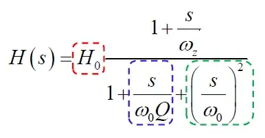

When writing the transfer function for a system, the Characteristic equation in the denominator which carries information about the poles of the system is equated with the standard second order transfer function denominator to find out the Resonant Frequency and Quality factor of the system.
Control to Output Transfer Function

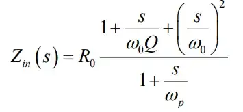

But in the Page 126 , when deriving the transfer function of the Buck converter Input impedance, the author equates the numerator which carries the information about zeros in the system to find out the Quality factor and Resonant frequency of Buck converter Input impedance.
Buck converter Input Impedance

  • Hello, there are no differences between the two approaches. Whether the 2nd-order polynomial lies in the denominator or in the numerator, you can always write it in a canonical form, highlighting a $Q$ and an $\omega_0$. When both the numerator and the numerator host a 2nd-order polynomial, I rewrite them with $Q_N$ and $\omega_{0N}$ for the numerator and $Q_D$ and $\omega_{0D}$ for the denominator. Let me know if it makes sense to you. – Verbal Kint Aug 30 '23 at 13:45
  • Also keep in mind that if $\frac{V_{\text{OUT}}}{V{\text{IN}}}=\frac{\left[\left(\frac{s}{\omega{{N_0}}}\right)^2+\frac1{Q}\left(\frac{s}{\omega{{N_0}}}\right)+1\right]}{\left[\left(\frac{s}{\omega{{D_0}}}\right)^2+\frac1{Q}\left(\frac{s}{\omega{{D_0}}}\right)+1\right]}$ then it follows that $V{\text{OUT}}\cdot\left[\left(\frac{s}{\omega{{D_0}}}\right)^2+\frac1{Q}\left(\frac{s}{\omega{{D_0}}}\right)+1\right]=V{\text{IN}}\cdot\left[\left(\frac{s}{\omega{{N_0}}}\right)^2+\frac1{Q}\left(\frac{s}{\omega{_{N_0}}}\right)+1\right]$. – periblepsis Aug 30 '23 at 14:18

  • @user15174, have a look at the answer I provided on SE. There is 2nd-order polynomials in the numerator and the denominator. In this example, the $Q$ are different but $\omega_0$ is common to both expressions. In the control-to-output transfer function of the voltage-mode buck, you have a $LC$ filter showing a resonance and a peaking depending on the losses in the circuit: this is what the 2nd-order polynomial describes. – Verbal Kint Aug 30 '23 at 18:26
