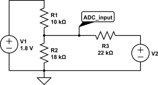

This can be done with three resistors!
schematic
No active components needed. Shifts -4 to 4V to 0-1.8V, perfectly linearly. V2 is your input voltage (-4 to 4V). V1 is just your 1.8V rail.
The input impedance is 22K, which won't load your motors to any significant degree, and the output impedance is about 5K, more than low enough to drive any ADC.

    After some remembering I could reproduce the calculations. That actually looks pretty need and simple, especially as I can test that on a breadboard before soldering it to something. Thank you very much. – the_summer Apr 26 '13 at 20:25
  • +1 for an elegant solution I learnt in school but had forgotten about entirely. – Anindo Ghosh Apr 26 '13 at 20:35

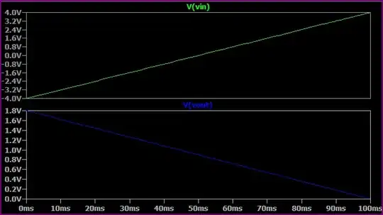

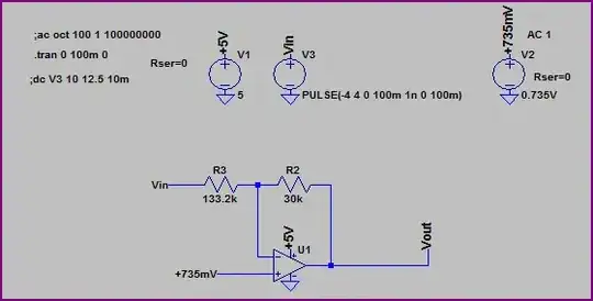

  1. Although a passive solution is possible, often depending on your source impedance and ADC input impedance, it's usually a good idea to use an opamp for the level/gain shift. One option is an inverting circuit such as this:
    Inverting Shift
    Simulation:
    Inverting Shift Simulation
    The benefit is a very low output impedance to drive the ADC (many ADCs require a minimum signal impedance of <10kΩ)
    The input impedance is just R3 (133.2kΩ in this circuit) To prevent loading effects, you want your signal impedance to be less than 10kΩ or so. If it's higher, you can increase R3 and R2 to increase the input impedance (as long as the ratio remains the same, so does the gain)
    Some opamps don't like a gain less than 1, so you need to check the datasheet to make sure it will be stable in this configuration. Also a small capacitor across R2 is usually a good idea to control bandwidth appropriately.
    The readings will be inverted, but it's easy to correct for this in firmware.
    A quad opamp with a decent voltage reference IC and divider to provide the 735mV reference for all non-inverting inputs could be used. The opamp must be able to swing its output down to ground; some op-amps cannot do this, so check the datasheet.
