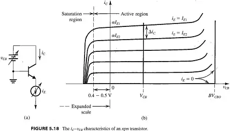

In amplifier theory, you specifically design amplifiers to be biased so that they have the largest 'dynamic range'. This refers to the peak amplitude of the waves that you can put in and get out of the amplifier. A good amplifier (which can be a single BJT and some resistors, look up Common Emitter/Collector/Base Amplfiers, etc) will have a very large dynamic range. You can get the largest dynamic range out of an amplifier by biasing it to be in the exact middle of the saturation region which is this flat zone along the IV curve of the BJT:
Our output wave comes out with a vertical (DC) offset equivalent to our biasing -- it 'rides' on top of the DC. This gives us our dynamic range. When we increase our amplitude of the input wave, the output wave will grow until it either hits the top (your voltage rail) or the bottom (the linear region), whichever is closer. Biasing in the middle gives us the most space on either side.
Why do we want to be in the middle? Again, because of that nice constant relationship between input voltage and current. If we were to fall into the linear/active region then the bottom part of your wave gets distorted.
So back to the diode: If we were to bias it to only 0.7V (a common forward drop voltage), then we couldn't ride any AC signal on top of it, since the bottom lobes would cause that voltage to dip below 0.7V and turn the diode off. So if we bias a 0.7V diode instead to 1V, we could then ride a .3V AC signal through it without worrying that it will turn off.
