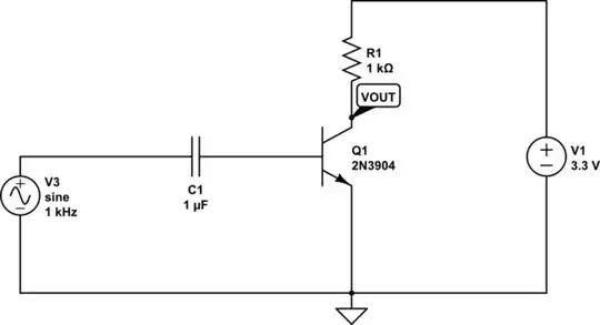

A thought experiment: 1) An AC signal (lets say, 100mVp-p sine wave) is applied to the base of a BJT through a capacitor. Nothing else is connected to the base of the transistor, the emitter is connected to ground, and the collector is connected to the positive power rail (lets call it 3.3V) through a 1k resistor. The collector voltage won't change as the sine wave at the base is applied.

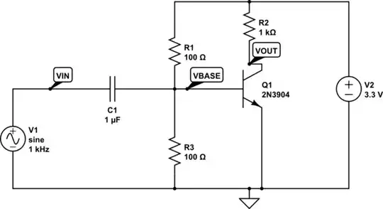

2) Now, imagine the same circuit, except that there is a base biasing network above 0.7V. The output voltage (Vout) will now be changed as the input voltage changes, since the BJT base is above the "cut-in" voltage (approx 600-700mV for silicon BJTs).
schematic
simulate this circuit
There are plenty of other considerations regarding temperature dependence, quiescent current, and input and output impedance of the circuit, among others. I'm just attempting to get you to a basic concept of one type of DC biasing.
