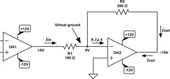

As an example, take a typical inverting op-amp configuration (OA2, R1, R2), whose input is provided by a prior op-amp stage (OA1):
schematic
Here OA1 is applying +5V at its output, and the inverting amplifier of gain \$-\frac{R_2}{R_1} = -2\$ should therefore produce an output of −10V. Let's calculate the corresponding input and output currents \$I_{IN}\$ and \$I_{OUT}\$, using Ohm's law:
$$ I_{IN} = \frac{(+5V)-(0V)}{100\Omega} = 50mA $$
$$ I_{OUT} = \frac{(0V)-(-10V)}{200\Omega} = 50mA $$
Considering that the largest current most op-amps are able to source or sink is about 10mA, clearly the outputs of both OA1 and OA2 are overloaded. The voltages we expect to be present in this design will not be achieved, because the op-amps are simply unable to comply.
If R1 and R2 are increased by, say, a factor of ten (1kΩ and 2kΩ respectively), then the currents involved are reduced by that same factor, to 5mA, which is within the capabilities of the op-amps, and will work just fine.
You could argue that increasing R1 and R2 by a factor of 10000 (to 1MΩ and 2MΩ) would also work, but then noise and interference become significant. Worse, \$I_{IN}\$ becomes so small that it is comparable with the op-amp's own input current (0.1μA in my example above):
$$ I_{IN} = \frac{(+5V)-(0V)}{1M\Omega} = 5\mu A $$
The closer \$I_{IN}\$ becomes to 0.1μA, the less "ideal" the behaviour of the system, and the less linear the relationship between input and output potentials.
Megohms is too much, hundreds-of-ohms is too little, and so here you would be considering values in the kilohms to hundreds of kilohms range. If this circuit is to be battery powered, then the higher end of this spectrum is better. If power supply isn't an issue, then the lower the better, kilohms is fine.

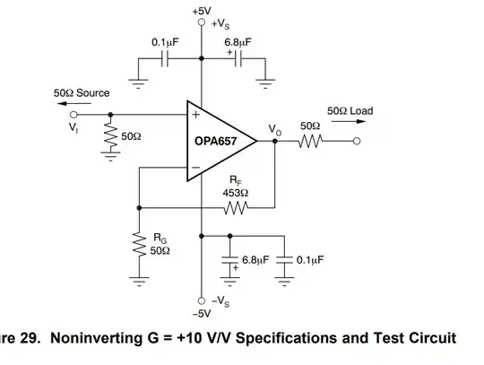

There are a bunch of considerations. For low frequencies, where power is not important and jellybean op-amps, resistances in the tens of kΩ to hundreds of kΩ are close to optimal. The optimal value range is not evident with ideal op-amps (eg. no bias currents, no input capacitance) or ideal circuits (eg. no parasitic capacitance). Typically the feedback resistor of 10kΩ or 20kΩ is good, which means the feedback current is less than 1.5mA (+/-15V supplies) to 150uA or so (3V supplies).
Op-amps have a bias current (or leakage current) that flows into or out of the inputs. Commercial op-amps have bias currents that might be in the range of close to 10uA down to a few fA. That's a range of >1000:1. A 20nA bias current (eg. LM358) into a 100kΩ resistance means an error of 2mV, which is in the same ballpark as the offset error of the op-amp, so getting significant.
Op-amps can only drive so much current from the output without excessive power dissipation or current limiting. Usually it's in 10mA to 30mA range for jellybean op-amps. So very low resistances can exceed that if the voltages involved are large. Plus it wastes power, which is very important in some applications.
Low value resistors have less Johnson-Nyquist noise, which is important in some applications.
Aside from bias currents affecting the DC output, using feedback resistors that are too high (without added compensation) reduces phase margin because op-amps have some input capacitance. High enough resistances with an op-amp that has a high input capacitance can result in oscillation. Some op-amps use a parallel interconnected array of perhaps 100 input MOSFETs (inverting and non-inverting input transistors interspersed) to help reduce offset voltage and drift, which results in relatively high input capacitance.
From here for example is a high-frequency amplifier circuit:
Relatively low resistance values are used because this circuit uses a 1.6GHz GBW op-amp and can have a pretty flat response with gain of 10 up to >100MHz.

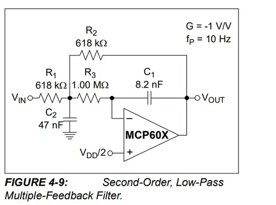

For low power, from here is an example of an active filter circuit that uses values in the MΩ range:
High value resistors mean that power consumption is less, and the capacitor values are proportionally lower in the filter circuit so there is more choice of capacitor types.

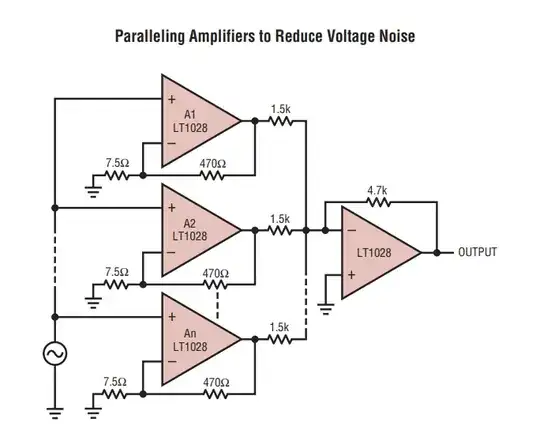

The simple answer would be: the fundamental trade-off between noise and power.
Larger resistors will draw less current. In a practical sense, this means the Op-Amps will not spend that much of their drive capability on the feedback network (when they are implemented with large resistors). Thus, small power dissipation due to feedback network.
However, the voltage noise associated with these resistors is rather large (i.e. \$\sqrt{4kTR}\$). You'd like to keep them small.
Therefore, we have a conflict.
The compromise is to use medium sized resistors. Most of the time, these happen to be in the \$10k\Omega-100k\Omega\$ range. But it's not always possible. Sometimes the noise specifications are so tough that all you can do is resort to capacitors to set your feedback network.
For any given linear network with n-nodes, if you duplicate this network and connect each duplicated node to its original node (i.e. a resistor that is connected between nodes a and b will now be placed in parallel with the same resistor value), you'll now get:
  • 2x current consumption
  • -3dB or \$\sqrt{2}\$ reduction factor in noise voltage
