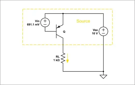

"Current source"
If we connect the transistor Q with its emitter to the positive supply rail, and the load RL to ground, we call it "current source".

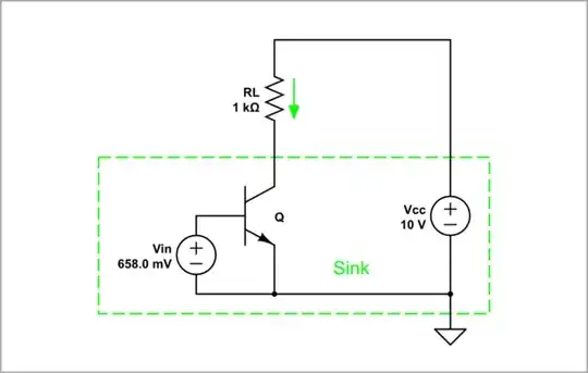

"Current sink"
If we connect an NPN transistor Q with its emitter to ground, and the load RL to Vcc, we call it "current sink".

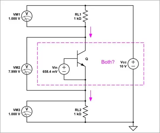

Both?

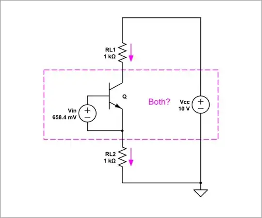

But what should we call (what is) the transistor when it is "floating" between two loads RL1 and RL2?
schematic
simulate this circuit
Circuit fantasist
  • 16,664
  • 19
  • 61
Q's collector is a current sink.
Q's emitter is a current source.
You can call Q whatever you desire.
The contents of the magenta box is neither a source nor a sink. There are two sources and two sinks within the box.1 source and 1 sink are mentioned above. The positive terminal of the 10V supply is a source. The negative terminal of the 10V supply is a sink.
The contents of the yellow box is not a source. The transistor collector is. As is the positive terminal of the 10V supply. The negative terminal of the 10V supply is a sink.
The contents of the green box is not a sink. The transistor collector is. As is the negative terminal of the 10V supply. The positive terminal of the 10V supply is a source.
Of course if you consider electron flow everything changes. Point of view is important.

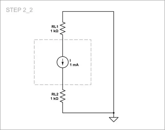

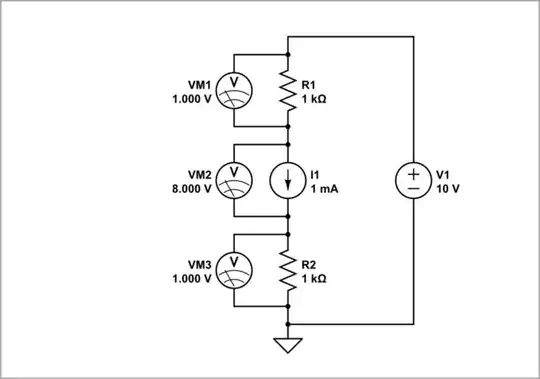

It is merely a floating current source.
Also, whether it is pushing/sourcing the current or pulling/sinking the current, it is still a constant current source.
schematic
UPDATE: Adding the same schematic with a transistor:
schematic

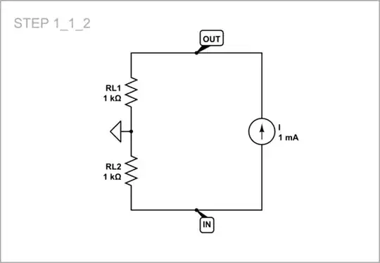

Floating sources
Both voltage and current sources are two-terminal devices and, in the general case, we see (work with) both ends of them. Thus, a voltage source has a positive and negative terminal, and as they say, the load will "see" both positive and negative voltage.
schematic
Similarly, a current source has an output and input terminal, and the load "sees" both.
schematic
A clarification: Since CircuitLab needs a ground, I have split the RL load into two parts (RL1 and RL2) and grounded the middle point.

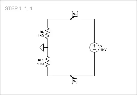

Grounded negative terminal
However, we prefer to use only one terminal and connect the other to a reference point (e.g., "ground"). In most cases (e.g. in cars) we prefer to ground the negative terminal and then we get a positive voltage. Figuratively speaking, the load "sees" a positive voltage V+.
schematic

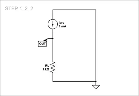

Similarly, if we ground the input terminal of a current source, the load will "see" its output terminal and will consider this device actually as a "source".
schematic

In the second part of my answer, I will consider the arrangement of interest where a floating current source is stretched through two resistors (RL1 and RL2) between the supply rails.
Ideal current source?
Let's first put an "ideal" current source from the CircuitLab library in this place.
schematic
The problem is that we do not know what is inside that circle with an arrow - is it a "true" current source that "produces" the current or an element that only keeps the current constant.
A source indeed
We can check it very easily by replacing the voltage source with a piece of wire. As we can see, the current continues flowing and the voltage across it reverses its polarity. So, we conclude, the CircuitLab current source is a true current source that contains energy inside.
schematic

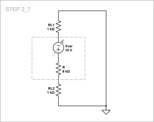

Dynamic resistor
The most popular thing to put in the circle is a "varying resistor" which has the property of changing its resistance so as to keep the current constant. To imitate it, open Rvar parameters and begin changing the resistance so that to obtain the desired 1 mA current.
If now I come and try, for example, to increase RL1 or RL2, you will feel this and decrease Rvar accordingly so that the total resistance RL1 + Rvar + RL2 remains unchanged and hence the current.
schematic
In real circuits, a transistor with constant base-emitter voltage does this boring work (see the schematic at the end of the question body). Also the so-called "constant-current diodes" made with JFET are a typical example ("diode" in the sense of a 2-terminal device, not PN junction).
Note that this is not a source in the literal sense of the word ("producing" current); it is a current regulating device. The current is produced by the voltage source V. The dynamic resistor is a passive device; so the voltage of its upper end is positive. As we saw above, the CircuitLab current source is not that.

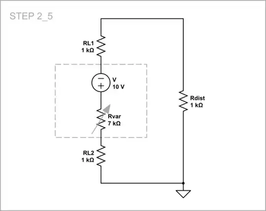

... dusturbed by resistance...
If I now come and insert a 1 k disturbing resistor Rdist, you will sense this and reduce Rvar to 7 k as above so that the total resistance remains unchanged (10k).
schematic

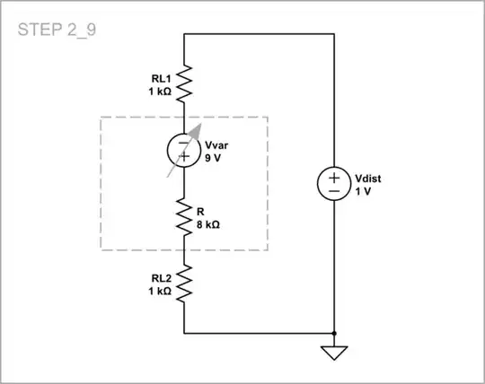

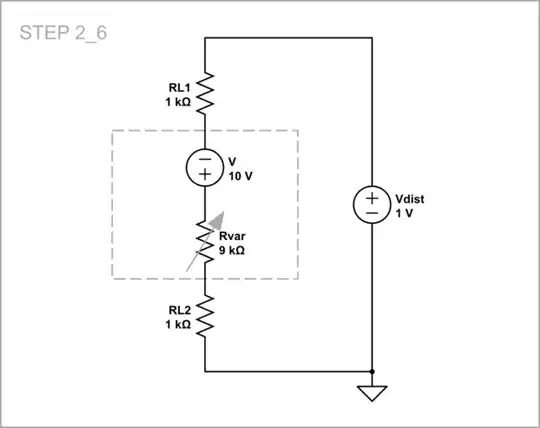

... or voltage
If I insert a disturbing 1 V voltage Vdist, you will sense this and increase Rvar up to 9 k so that the total current of 1 mA remains unchanged. And v.v., if I reverse Vdist, you will decrease Rvar to 7 k.
schematic

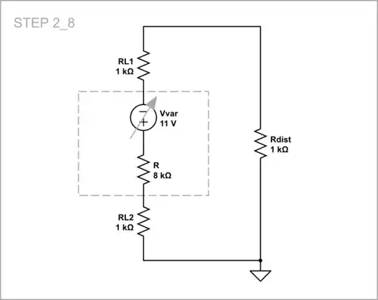

... disturbed by resistance...
Now if I insert 1 k disturbance, you will increase V to 11 V to compensate the disturbance and keep 1 mA current.
schematic
