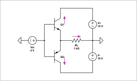

I thought about this question when I read an interesting comment by @Simon Fitch in his answer.
In the complementary amplifier stage, in total there are three "pulling" elements - Q2 is a "pull-down" transistor when Vin is negative, Q1 is a "pull-up" transistor when Vin is positive, and the load RL is constantly a "pull-middle" resistor :-)
schematic
Push-pull graph
However, for some reason, this configuration is called "push-pull" stage. So there should also be a "pushing" element.
My question is, "What is it?"

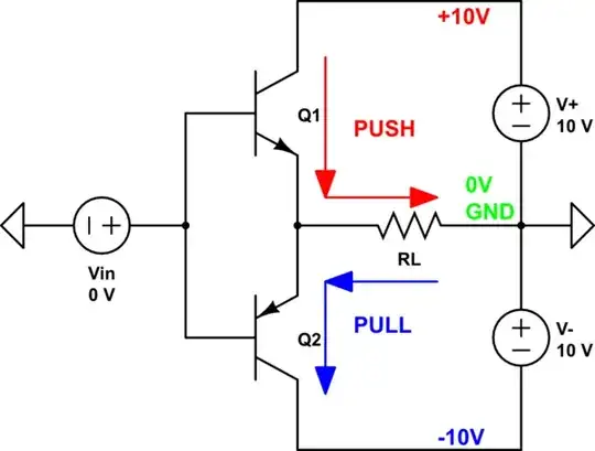

"Push-pull" refers to the current through the load at the output of a pair of transistors placed as a "totem-pole" or one above another.
EDIT: Thanks to the user Chester Gillon whose answer below contains an actual link to a Texas Instruments page saying the same thing (link).
schematic
  • 0v or GND: In your schematic, the ground is halfway between the positive and negative supply voltages, or at 0V.
  • PUSH: When the upper transistor (Q1) conducts, it lets the current flow from the positive voltage through it and through the load (RL) to the 0V (zero volts) or ground point.
    Since the classic (conventional) direction of current is considered to be from positive to negative, this is considered pushing the current from the positive output to the ground, as well as "pushing" the voltage on the amplifier's output "up" towards the positive supply voltage.
  • PULL: When the lower transistor (Q2) conducts, the (conventional) current flow is from 0V/ground through the load (RL) and through the Q2 transistor to the negative supply voltage.
    Thus, it is called pulling, as it supposedly pulls the current from the 0V side of the load down to negative output of the amplifier, and also the voltage on the amplifier's output side down towards the negative supply voltage.
  • CONCLUSION: The upper transistor does the pushing, and the lower transistor does the pulling in this (type of a) circuit.

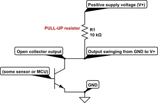

PULL-UP and PULL-DOWN typically refers to bringing an INPUT of a circuit UP to the positive supply voltage or DOWN to the negative side or 0V (zero volt) side to have a defined voltage level when there is no input signal and/or to change the voltage range of the input signal.
One example is an Arduino or ESP32 output only giving from 0V to +3.3V PWM signal, but you might need from 0V to +10V to drive a MOSFET. An ESP32 output drives an NPN transistor which is connected in an open-collector circuit where 0V remains about 0V, but the upper voltage or logic 1 now extends all the way to the positive supply voltage to which the pull-up resistor is connected.
AN EXAMPLE SCHEMATIC:
schematic
simulate this circuit

  • Great explanation... Just to ask, "And which way does the RL load "pull" - "up" or "down" :-)? I'm putting a smiley face because it might look quite strange to the reader... – Circuit fantasist Apr 23 '23 at 21:43
    @Circuitfantasist The potential on the left side of the RL (towards amplifier output) is "pulled-up" towards the positive voltage side when Q1 is on, and it is "pulled-down" towards the negative voltage side when Q2 is on. The ground or 0V side of the RL is the "reference point". Also, the RL or the load ITSELF is not doing the pushing or pulling, it is actually resisting the pushing and pulling of a current through it. – Edin Fifić Apr 23 '23 at 21:55
  • But RL also "pulls down" in the first case and "up" in the second one, right? So, in the first case, a positive-supplied voltage divider Q1-RL is formed, and in the second case, a negative-supplied voltage divider Q2-RL is formed. When Vin = 0, third "voltage divider" Q1-Q2 is formed; RL does not play any role since the voltage drop across it is zero. – Circuit fantasist Apr 23 '23 at 22:04
  • And to add something to your last edit (bottom picture). Don't you think that R2 is exactly the same "pull-up" resistor as R1? And that R1 + Q0 is the same as R2 +Q1? I.e., R1 converts the open collector resistance output into an ordinary voltage output? And to take this opportunity to express my admiration for your explanations; I really like them because they show a real understanding of circuits. I follow them with interest... – Circuit fantasist Apr 23 '23 at 22:13
    @Circuitfantasist You're right, I overdid it! :D Oops! The open-collector was supposed to be inside a sensor, but then I added MCU and confused myself.. – Edin Fifić Apr 23 '23 at 22:14
  • @Circuitfantasist The PULLING-DOWN means pulling BELOW ZERO VOLTS or GROUND. So, no, the RL is not doing the pulling down, because the lowest it can "pull-down" to is the midpoint, ground or 0V. Same for its "pulling up". If you connect its ground side to the positive supply voltage, THEN it will be pulling up, and vice versa. – Edin Fifić Apr 23 '23 at 22:22

From the point of view of the load \$R_L\$, Q1 pushes current into it, and Q2 pulls current from it.
I would not call an emitter-follower (which both transistors are, in this circuit) a pull-up or a pull-down, but terminology can vary.
