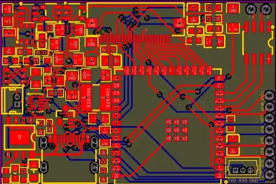

In my last question I found out that having two different layers for Ground and Analog Ground may induce capacitive coupling. Now I want to ask more generally if the idea I had is worse than connecting DGND and AGND on the same plane. May PCB stack-up is currently as follows:
Signal, DGND, AGND, Signal
My PCB looks like this:
So there is an ESP32-S3 (bottom right), MAX6675 temperature sensor (top right), camera interface (SCCB) working at 20 MHz (top mid), Li-po charging circuitry (top left), Li-po protection circuitry (top left), 3.3 V power supply (left mid), 1.5 V and 2.8 V power supplies (left of cam connector) and an ADC (ADS1110) above the battery connector.
To the AGND plane is only connected the AGND Pin of the 3.3 V power supply and the AGND pin of the camera.
If it is a bad idea, how can I make it better?

My PCB Stackup is currently as follows:
Put DGND and AGND on the same layer to avoid the problem that you mentioned (capacitive coupling) and, to keep both GNDs close below the components they are acting as a GND-plane for.
You just need to figure out how and where you connect the AGND and DGND planes (hint a single point connection at the junction of some type of analogue to digital conversion I.C. is normally recommended).
Andy aka
  • 456,226
  • 28
  • 367
  • 807
  • Okay but I have to have 4 layers, because you can only choose from 2 or 4. So should I switch to Signal - GND - GND - Signal or GND - Signal - Signal -GND? Or does it make sense to transform the Analog Plane into a power plane? (I have 1.5V, 2.8V, 3.3V power supplies, can I all put them in that power plane? – Cem Pamir Bana Mar 31 '23 at 07:57
  • I always have signal on the outer layers because, if I screw up, I can fix with track cuts. The DC stuff might conveniently go on the middle plane furthest from the component side. – Andy aka Mar 31 '23 at 09:36
