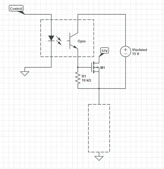

  • so if i could use a B1212S-1WR3 or the like connected to BASE with a EL3H7 optocoupler, to drive the base high and that would work fine? (i was expecting to find an IC that did something along these lines) – Jay Dee Mar 25 '23 at 01:48
  • If you do not also a low-side NMOS to drive, there is no point to a typical high-side gate driver IC. These are intended for things like half-bridges. If you only have a high-side NMOS to drive, the only thing you would really be using from the IC is the level shifter to control floating circuitry from a ground referenced signal. You would still need to add floating regulators and such since there is no low-side switch to refresh a bootstrap cap. – DKNguyen Mar 25 '23 at 01:50
  • Discrete solutions are by pairing an isolated gate driver or optocoupler with an isolated regulator floating with the high-side NMOS on the other side. However, there are ICs that contain integrated charge pumps meant for to drive NMOS load switches but these usually only float under 12V. If you do use something like optocouplers, remember that if an optocoupler does not have a push-pull output (most don't...they are just a transistor that conducts or blocks) then they cannot drain the gate-source capacitance to turn off the MOSFET. You need something else to do that (like a pull resistor). – DKNguyen Mar 25 '23 at 01:50
  • ok, thank you for your help, please could you post an answer of a basic circuit diagram with a DC-DC isolator, optocoupler and, NMOS and i will try it – Jay Dee Mar 25 '23 at 01:55
  • Edit your answer to post a representative circuit of what you are doing. It only became clear in the comments that your circuit is a 100% duty cycle high-side load switch without an accompanying low-side MOSFET and not something else. – DKNguyen Mar 25 '23 at 01:56
