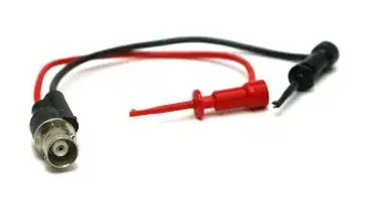

  2. Mini-grabbers like this with the spring-loaded hook are an ok solution for bigger stuff, but no good for little surface mount components. I can solder on little bits of wire and then mini-grab those, but it's tedious and time-consuming. And in my experience they tend to be broken more often than not:
    minigrabbers

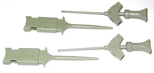

  3. I got some Tektronix KlipChips and some HP 5090-4356 clips on eBay.
    Tektronix KlipChips and HP 5090-4356

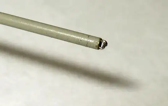

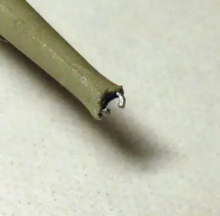

    The Tektronix clips are hard to open, because the plastic head tips to the side and jams instead of sliding down when you try to squeeze it. The HPs don't have that problem. The Tek pincers are made of wire, so they splay out sideways instead of grabbing well (and get permanently bent, making them jam on each other and not close completely, so connections to thin wires are intermittent).
    Wire tips jammed together
The HP pincers are made of thin strips of metal, so they are more rigid in that direction. The wire pincers depend on the bendiness of the wire to overlap each other side-by-side (which doesn't work very well) while the HP pincers fold inside each other, with one a little shorter than the other. This seems to work better, but they get bent outward, and the tubes are plastic, so they get bent outwards by any angular stress and no longer close well.
Tip splayed open
The orientation of the pincers on the HP relative to your fingers is more natural.
These work on SOICs or bigger, but after they've become worn they don't stay on as well. They don't work for surface mount resistors (they just pop off if disturbed even a little) or smaller-pitch ICs.

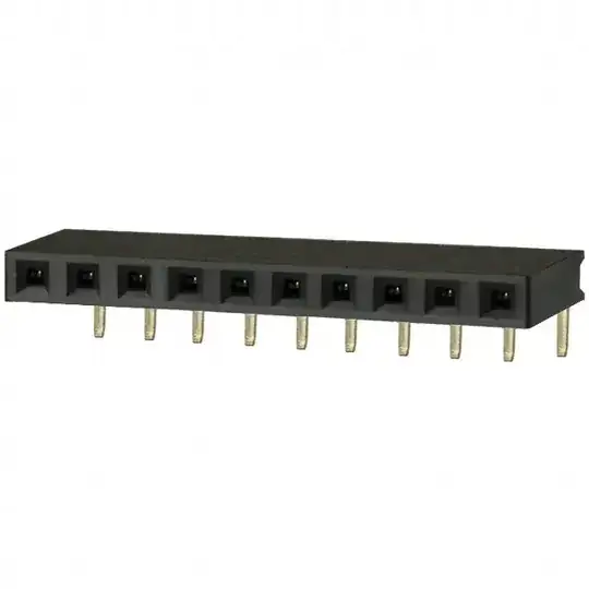

I have lately switched to Digikey part S5493-ND (picture follows). This mates with the Open Workbench LA. Or I can plug a normal pin header in for oscilloscope connections or whatever.

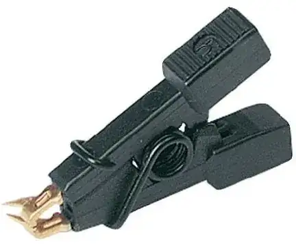

For passive components there are small spring-loaded plier-like probes with two 0.6mm contacts from Hirschmann.
For IC pins there are some really small ones from Pomona 6351/6352/6353, though the price is inversely related to the size (or maybe the square of the size?), so these are really expensive. I've used two of these on adjacent pins with 0.5mm pitch (unfortunately they weren't mine).

Those Pomona grabbers starblue posted are great and work very well but they break very easily and you would have to support most of the weight of the grabber or it will come of the pin. I'd say they are not worth it for home use unless you are extremely careful and use them sparingly. They do work very well once you get one on properly. Unfortunately I don't know of anything else except for soldering or holding a probe on the pin as an alternative.
