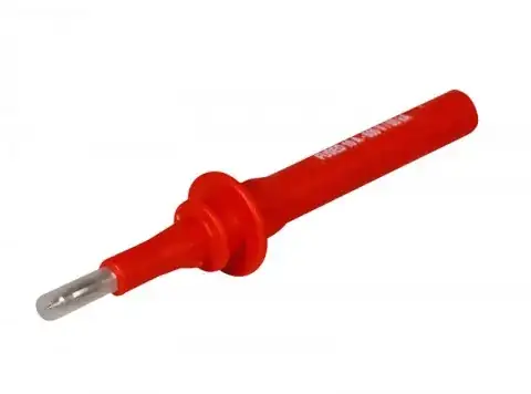

Just what the doctor ordered:
Fused probe bodies with 4mm contact tips. The tip are covered with a spring loaded sheath for added protection. Unscrew the tip to access and replace the fuse. Probe bodies are marked with the rating of the internal fuse.
From Cal Test electronics $14.93.
Materials: Body: Polyamide (Nylon); Contact tip: Brass, Nickel Plt. Banana Contact: BeCu, Nickel Plt. Set available in red and black pair

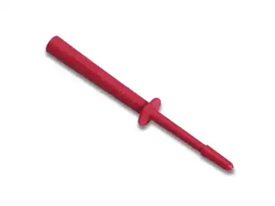

RS India grip probe.
Made to grip a standard test point

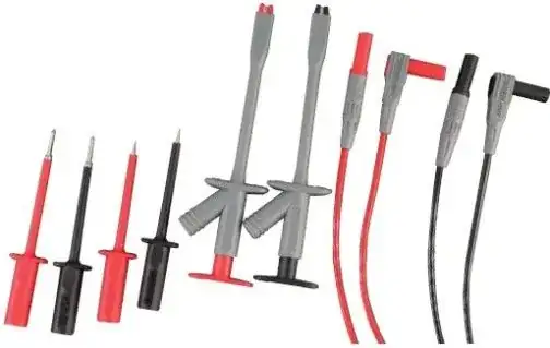

Extech TL810 Electrical Test Lead Kit, Double insulated with CAT III-1000V safety rating, Two 40" (1m) PVC lead extensions (1000V rating) with shrouded banana plugs on both ends, Two very sharp, extra long 0.3" (7mm) stainless steel tipped plug-on test probes, Two stainless steel flat tip test probes (0.6"/15mm long), Two plunger activated retractable jaw clips with a wide 0.75" (19mm) jaw opening (TL-810 TL 810) $45/set From

  • Thank you, Those Cal Test Probes might do the job. I emailed them. I am not sure of their size. They look like regular sized DMM probes and if so I will buy them. – Russ Sep 09 '11 at 22:57
  • I called Cal Test and the first probe that I thought might work I don't think will. They said it was mainly made for HVAC work and not for probing small things. I did order a few of the probes they recommend but they are not exactly what I had in mind. – Russ Sep 28 '11 at 21:45

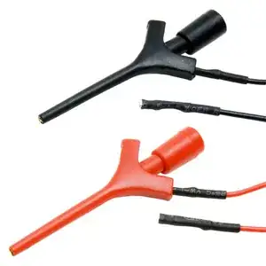

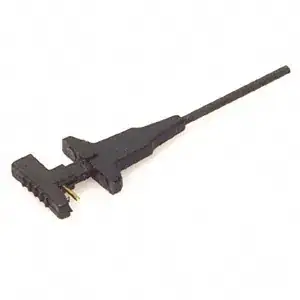

I would recommend the following type of test clips:
Some of these have really fine tips,
which, when closed are almost completely retracted in the sheath. This is a lot better than the hook of a standard scope probe, which is too long and protrudes so that it can easily cause shorts. I find that these smaller ones don't get loose easily, and can be easily used for SMD pins. You may have to power off your devices before connecting the pins, as they may short to the neighboring pins when connecting. Once they're in place you can power up again.
This kind of clips is often used with logic analyzers where many clips have to be placed on several IC pins, often next to each other.

  • The problem with the ones that grip around the pin is that on chips with real close pins, unless I power down I risk shorting between pins. – Russ Sep 09 '11 at 22:59
  • I sometimes work on CRT monitors and constantly powering up and down when doing simple voltage checks isn't the fastest way to work and perhaps not the best for the monitor. – Russ Sep 09 '11 at 23:05

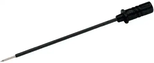

I have some nice small Hirschmann probes:
http://www.conrad.de/ce/de/product/104400
They have rather sharp tips, so they don't tend to slip, but not as sharp as a needle, so it doesn't tend to cause injuries. The tip is spring-loaded, which helps to avoid excessive force.

  • Yes, the sharp tip helps but when I am so concerned about slipping I press the tip into the pin firmly because I don't want it to slip but the pressure I apply seems to contribute to slipping even more if there is a problem holding it down. – Russ Sep 09 '11 at 23:02
  • As I said, they are spring loaded. The 7mm long metallic tip retracts all the way into the colored sheath if you push it, so it's easy to keep the force about right. – starblue Sep 11 '11 at 09:01
  • I did order some probes from Cal-Test that seem to do this. The metal tip retracts back into the probe when pressed down and there is a clear plastic cover that surrounds the tip so you can line it up correctly. I will give them a try to see how they work. Thank you. – Russ Sep 28 '11 at 21:50
