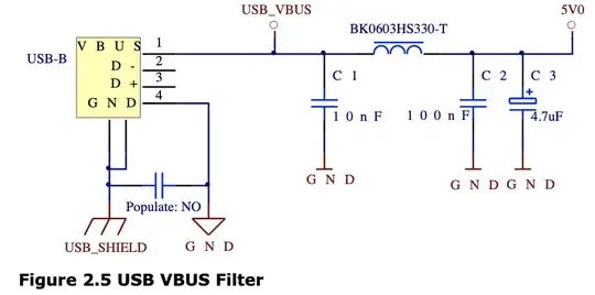

I am reading an old (2013) FTDI application note AN_146 about hardware design for USB 2.0. On the subject of VBUS filtering, it says this:
2.4.4 Ferrite bead use and placement – USB peripheral devices
The USB specification prohibits the use of ferrite beads on the USB DP and DM data signals. It does, however, recommend them on the USB power signal (VBUS). It’s common to add bulk and decoupling capacitors as shown in Figure 2.5.
The 10nF capacitor and ferrite bead should be placed as close to the USB connector as possible.
figure 2.5
I have a few questions regarding this circuit:
  1. Why is C1 connected to the left of the ferrite, while C2 (decoupling) and C3 (bulk) are connected to the right of the ferrite?
  2. The combination of C1 and the ferrite look like a low-pass LC filter to me. So, this design would still allow low-frequency A/C noise to pass through, correct?
  3. Why does C3, the bulk capacitance, need to be a polarized capacitor? Were 4.7 μF ceramics just not available in 2013? Or is there some deeper reason why the bulk capacitance needs to be a polarized cap (e.g. something to do with ESR)?
  4. What does 5V0 mean? I've seen this net name used in other USB circuit diagrams (figure 1 here for example). Is 5V0 a convention used to indicate something different from regular old 5V or +5V?

Pi Filter
This circuit is called a "pi filter", named because it has a similar shape to the Greek letter π - one series inductor in the middle of two shunt capacitors.
It's a common topology in high-frequency EMI filters. It's simply an LC filter with an additional capacitor placed in front of it. The idea is that the first capacitor can already remove some noise before it enters the filter. One can argue that the pi filter really is a 2-stage LC filter, the first "hidden" inductor is the power cable.

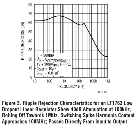

In a small pure-digital device, such as a USB dongle, low-frequency noise is usually a non-issue. Low power consumption means that even a small bulk capacitor is sufficient as a reservoir capacitor. Furthermore, the voltage regulator already acts as a low-frequency active filter. Below 1 MHz, any 5 V to 3.3 V linear regulator can provide a Power Supply Rejection Ratio around 20 dB to 60 dB, switched-mode DC/DC buck converters are not as good but they're still regulated in a similar way. Finally, a single cycle of 50/60 Hz noise is an eternity for a 10 MHz or 100 MHz processor.
Figure 3. Ripple Rejection Characteristics for an LT1763 Low
Dropout Linear Regulator Show 40dB Attenuation at 100kHz,
Rolling Off Towards 1MHz. Switching Spike Harmonic Content
Approaches 100MHz; Passes Directly From Input to Output
Source: Minimizing Switching Regulator Residue in Linear Regulator Outputs, by Jim Williams
The real problem is high-frequency noise (i.e. EMI) from 1 MHz to 1 GHz due to rapid switching of digital logic and DC/DC power converters. As wires act as antennas, if conducted interference is not filtered, they may become radiated interference. Thus, it's considered a good habit to always include an LC filter at the entry of the powerline to stop high-frequency interference from leaving (the main concern) or entering our system.

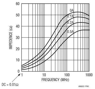

To remove high-frequency differential-mode noise (common-mode noise is another can of worm, beyond the scope of this article), a ferrite bead is the component of choice in an LC filter. At low frequencies, ferrite beads behave like small inductors - but it's not their true purpose. At high frequencies above 100 MHz, they act like resistors as its magnetic material is deliberately designed to produce core loss.
Figure A1. Impedance vs. Frequency at Various DC Bias Currents
for a Surface Mounted Ferrite Bead (Fair-Rite 2518065007Y6).
Impedance is Essentially Zero at DC and Low Frequency, Rising
Above 50Ω Depending on Frequency and DC Current. Source:
Fair-Rite 2518065007Y6 Datasheet.

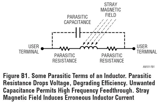

Alternatively, one can also use an inductor around a few microhenries. But it comes with some possible downsides. Because an inductor has many turns in the winding, they generate more DC power loss than ferrite bead - which only has a few turns. A higher number of turns also means higher parasitic capacitance, making the inductor unable to filter anymore at some point above 100 MHz. Meanwhile, a ferrite bead operates primarily through core loss, theoretically they can be effective even at 1 GHz (but only with perfect layout and shielding, don't expect to see it in a real circuit).
Figure B1. Some Parasitic Terms of an Inductor. Parasitic
Resistance Drops Voltage, Degrading Efficiency. Unwanted
Capacitance Permits High Frequency Feedthrough. Stray
Magnetic Field Induces Erroneous Inductor Current

Damping an LC filter
Why does C3, the bulk capacitance, need to be a polarized capacitor? Were 4.7 uF ceramics just not available in 2013? Or is there some deeper reason why the bulk capacitance needs to be a polarized cap? (e.g., something to do with ESR)
First, "use electrolytic capacitors as bulk capacitors, use ceramic capacitors as high-frequency capacitor" is just an outdated habit for many people. I'm not a fan of it. For such a small value, on the surface, there's no real advantage other than saving perhaps a few cents.
But there's indeed a deeper reason. The high ESR of the electrolytic capacitor forms an RC damper to suppress possible resonance of the LC filter (the same can also be implemented by a 6.8 uF ceramic capacitor in series with a 0.25 Ω resistor, which is the solution I prefer).
The usual practice is using a generic (not low-ESR) wet-electrolyte aluminum electrolytic capacitor. As a rule of thumb, use a large bulk capacitor 10x the size of all the other capacitances combined. So this value is around 100 to 1000 uF.
However, in this particular example, since the maximum capacitance of a USB device is restricted by the specification to avoid excessive voltage droop at the USB port, only a 10 uF can be connected at a time. Due to high ESR of small aluminum electrolytic capacitors (it needs to be high, but not too high, definitely not much greater than 1 Ω), this trick only has very limited effect and can even backfire. Solid-electrolyte aluminum capacitors or tantalum electrolytic capacitor may have just the right ESR for this purpose, but I haven't investigated it so I'm not sure.
The ceramic capacitor in series with an SMD resistor is a better solution. For such a small capacitor value, there's no need to use electrolytic capacitors.

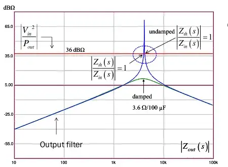

Overview
An LC circuit is good at removing noise, but it also has the side-effect of creating resonance at its natural frequency. Worse, modern ceramic capacitors are so great that they're very close to ideal capacitors in terms of ESR, so this resonance would have a high Q - great when you actually want a resonator, but just like many well-known examples from mechanical engineering, an unintentional resonance can also be detrimental in electronics.
Output impedance of undamped LC filter
Source: Input Filter Interactions with Switching Regulators, by Christophe Basso
There's a chance that the external noise or the operating frequency of your circuit happens to match the filter's resonance frequency, in this case, instead of removing the noise, the filter ironically causes a significant increase of noise voltage. If your circuit contains a switched-mode power supply and you're especially unlucky, the worst-case scenario is the complete destabilization of the power supply - a voltage-regulated power supply has negative resistance, turning it into an oscillator.

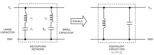

The series LC filter is not the only unwanted resonator lurking in a circuit, there are more! Another common source of unwanted resonance is when a large bulk capacitor is used in combination with a small bypass capacitor. Due to parasitic inductance, at high frequency, the big capacitor acts like an inductor. Thus, they form an parallel LC resonator. At the resonant frequency, the power supply impedance goes to the moon, from 0.01 Ω to 1 Ω or more. The circuit behaves as if it has no capacitor installed at this exact frequency.
Figure 11-15. (A) Decoupling network with two different value capacitors, and (B) the equivalent circuit of A for a frequency = where f_r1 < f < f_r2
Source: Electromagnetic Compatibility Engineering by Henry Ott, fair use.
In many designs, both kinds of resonance problems are often overlooked or ignored entirely: LC filters or ferrite beads are often added with a "just in case" mindset, and similarly, the suggestion is often given to use "multiple values of capacitors, 10x apart, such as 0.1 uF and 1 uF" , without additional thought. These circuits usually work without any apparent problems - resonance only occasionally causes problems. However, a good circuit design should be robust, thus it's a good design practice to suppress resonance in an LC filter by installing a damper.
This is usually achieved by connecting a small resistor in series with a large capacitor. The small resistor creates energy loss in the "LC resonator", killing the oscillation. The large capacitor ensures the resistor only dissipates at AC, not at DC, otherwise it would be a short-circuit.

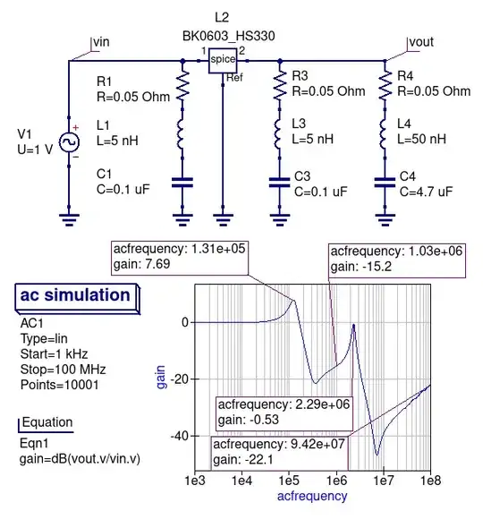

Simulation
Notes on modeling:
  1. At low frequency, ferrite beads behave just like small inductors, at high frequency, they behave like resistors. The inductance value is often not obvious in the datasheet, but it can be calculated from the impedance chart, alternatively, I just downloaded the SPICE model (S-parameters also work) of the ferrite bead for a quick simulation.
  2. The ESR of ceramic capacitors is extremely low in general, thus I used 0.05 Ω, in series of 5 nH parasitic capacitance, which is typical for SMD parts placed as close as possible. The 4.7 uF bulk capacitor has 50 nH of parasitic capacitance, an optimistic value of parasitic inductance from the layout. For an electrolytic capacitor, an additional 50 nH is added - electrolytic capacitors have high ESR and ESL, and useless for high-frequency filtering - they're only used as a bulk capacitor.
  3. These simulations are only for illustrative purposes. Your mileage may vary, especially your circuit parasitics. If filter or power delivery performance is really important, sweep your board with an impedance analyzer.
As you can see, the ferrite bead is highly effective, creating an attenuation of 15 dB at 1 MHz and 20 dB at 100 MHz. However, at 130 kHz, it instead creates a 8 dB of voltage gain due to resonance from the LC filter.
Since a ferrite bead is used, the result is actually better than I expected. For inductors, this gain can easily reach 20 dB. If any operating frequency or noise locates near this frequency, the result would be disastrous. Are you feeling lucky? It's also interesting to note that due to different capacitor values in parallel, another resonance occurs at 2.3 MHz with 0 dB attenuation, rendering the filter useless. But a ferrite bead is meant to filter high-frequency noise around 100 MHz or so, not low-frequency noise, so I would give it a pass...
Simulation of the LC filter with ceramic capacitors
Then, watch what happens when a 0.25 Ω resistor is inserted in series with the 4.7 μF capacitor. The 130 kHz resonance is suppressed, with only 1.3 dB of gain. The 2.3 MHz resonance also disappears.
However, the attenuation at 350 kHz reduced from 20 dB to 10 dB, but such is the price of removing resonance, and it's usually worthwhile. Combining bypass capacitors of different values creates deeper attenuation at many frequencies, but at the expense of high peaks without attenuation.
Simulation of the LC filter with ceramic capacitors with damping resistor

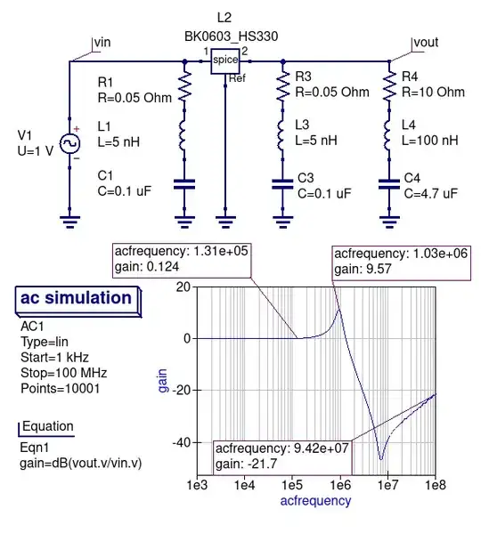

Now, try a 4.7 uF electrolytic capacitor instead. For a small capacitor, the ESR can be as high as 50 Ω at mains frequency. However, it's difficult to find clear data on high-frequency ESR. A Vishay datasheet seems to suggest 3 Ω for a good-quality aluminum capacitor with wet electrolyte (but you probably can't rely on this value as it can vary greatly depending on the model and vendor).
Simulation of the LC filter with an electrolytic bulk capacitor
The 130 kHz resonance is completely suppressed without a trace. There's a small resonance at 1 MHz with 3.3 dB gain due to paralleling capacitors, but it's low enough to be safe. The disadvantage is that there's no filtering at all at low frequencies, meanwhile its high-frequency performance is unaffected with 20 dB attenuation at 100 MHz. As a ferrite bead is only meant to filter high-frequency noise around 100 MHz or so, not low-frequency noise, it's an acceptable solution. In my opinion, the bigger problem is the ESR of small aluminum electrolytic capacitors cannot be relied upon.
Thus, overall, in this particular case, I prefer the second solution: 4.7 uF ceramic capacitor with 0.25 Ω resistor. Because a typical 16 V, 0603 ceramic capacitor loses 30% of its capacitance under a 5 V bias, select 6.8 uF instead.

Simulation of the LC filter with a 10Ω-ESR electrolytic capacitor

  1. The cable has inductance so it is best to have a small capacitor right at the connector for some filtering. It lowers the impedance of cable side. It prevents high frequency AC noise from entering or exiting the cable. Basically for EMI reasons. An L-C-L filer is called a pi filter due to the shape of it. It is better than just LC filter.
  2. Yes C1 with ferrite is a low pass filter. But just enough to pass EMI compliance testing. Lower frequencies are not a problem, if you blink a LED then your device anyway has non-DC consumption which varies.
  3. Your guess is as good as mine. Sometimes higher ESR bulk caps are used so they don't cause a huge inrush current, which coule cause high voltage spikes due to cable inductance. It damps the ringing and oscillations somewhat. Also it might be that tantalum or electrolytic were just the de facto caps cheap and good enough back then.
  4. It just means 5.0 volts, just like 3V3 means 3.3 volts.

  • Regarding 3: electrolytic and tantalum have significant ESR, providing dampening of the LC system. (Polymer types may be available in high enough ESR to be useful here too. Of course you can do the same with a low-ESR polymer or ceramic plus external resistor.) – Tim Williams Jan 07 '23 at 01:39
  1. Why does C3, the bulk capacitance, need to be a polarized capacitor?
Polarization is not the issue. Most ceramic capacitors are very voltage dependent, even at low voltages. The higher values are difficult to obtain in non voltage dependent ceramics like C0G/NP0 types.
Electrolytic capacitors are not voltage dependent and higher values are easily obtained. But they do have higher ESL and so are inductive a higher frequencies, so where important, the electrolytic is often paralleled with a ceramic as is shown in your circuit diagram.
