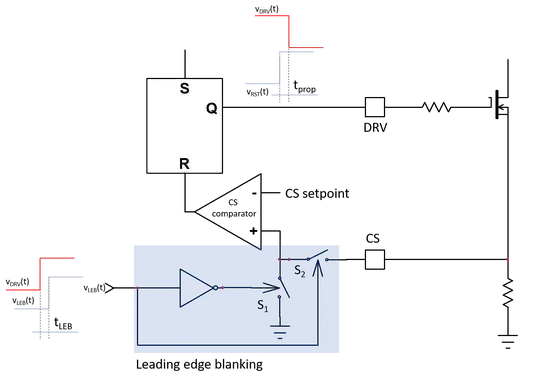

The minimum on-time is usually specific to current-mode control and defines the shortest pulse the circuit can deliver. There are two contributors to this minimum on-time:
  1. propagation delay, \$t_{prop}\$: when the current-sense comparator detects that the current setpoint is met, it instructs the logic to turn the DRV pin low which will turn the MOSFET off. However, before this happens, the signal must propagate through all logic blocks and it takes a certain time depending on various factors (technology, bias currents etc.). A classical figure is 100-200 ns for PWM controllers.
  2. leading edge blanking time, \$t_{LEB}\$: a LEB circuit is inserted between the current sense pin and the current-sense comparator. Its role is to blind the comparator for a small duration time (usually 100-150 ns) when the DRV pin turns the MOSFET on. This is to avoid erratic tripping with parasitic signals brought by various contributors at turn on (gate current, sec. side diode recovery process in CCM, stray capacitance and so on). A LEB is thus a kind of active filter.
The minimum on-time is thus: \$t_{on,min} = t_{prop} + t_{LEB}\$. You can observe it on a breadboard if you connect the drive output directly to the drive pin: the circuit will try to shut off immediately but will deliver a minimum pulse width. The below circuit illustrates the role of these blocks in a PWM controller:
Verbal Kint
  • 21,968
  • 18
  • 55
  • Hi, Thank you for your answer. Why the minimum on time does not depend on the MOSFET used ? Because if the MOSFET has a big input capacitor, the MOSFET will not have the time to switch ON – Jess Mar 28 '24 at 08:09
    Yes, it is another limiting factor: if the $C_{iss}$ is too large and the driver output resistance quite high, then it integrates the drive pulse which, at some point, can no longer properly lift the gate. – Verbal Kint Mar 28 '24 at 18:11

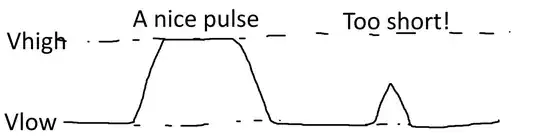

what is this minimum on time?
No circuit can output an infinitely short pulse, whether it's a logic gate or a MOSFET driver. They all have a speed limit, and therefore a minimum output pulse time below which the output will begin to go in the other direction before it has reached the flat top level of the pulse, turning a nice rectangular pulse into something more like a triangle. So there is a minimum off-time limit imposed by the driver chip itself. It can't go faster and still output a clean pulse.
However the MOSFET also adds another constraint: if the FET turns off immediately after turning on, or even worse if it doesn't have time to turn on completely then turns off immediately, then it will incur switching losses but it will do almost no actual useful work.
In a DC-DC converter, the FET is only doing useful stuff when it is conducting current. In fact, in an ideal converter the FET would switch instantly, so it would always be either on or off, and never in-between, so there would be no switching losses.
Basically, when on-time is large relative to switching time, it's worth it to pay switching losses, then pass a good amount of energy through the FET. Otherwise, it is more efficient to avoid switching losses by not switching at all, and skip cycles or go to sleep instead, operating the DC-DC converter in discontinuous mode. This also saves the energy required to drive the gate.
DC-DC chips designers take this into account and will usually pick a minimum on-time value that is not necessarily related to the fastest pulse the driver can output, but rather something reasonable to keep the converter efficient.
There are other constraints, for example if the chip samples the current through the FET only while it is on, then this requires a bit of time, and it has to stay on for longer than that for it to work.

  • As I understand it, discontinuous mode just fully uses the inductive energy on each cycle (inductor current reaches zero). In continuous mode the inductor current varies between a maximum and minimum value each cycle. With pulse cycle skipping, usually for very light loads, the converter does not drive the inductor on each transition of the PWM frequency, but waits until the output has dropped a bit further before giving a pulse. This effectively reduces the PWM frequency while giving a minimum ON time pulse, and allows lower duty cycle. – PStechPaul Dec 17 '22 at 20:16
  • Yes, that's the idea. On light loads, it is more efficient to use either discontinuous mode or bursts followed by sleep, this reduces switching losses, at the cost of higher output voltage ripple. – bobflux Dec 17 '22 at 21:45
  • +1. This answer could be improved by pointing out that "the minimum on time" (the width of the shortest pulse) is independent of and typically designed to be much longer than "the time required to turn on the power MOSFET switch ... turn ON time" (the rising edge of the output of the MOSFET). – davidcary Dec 19 '22 at 18:57
