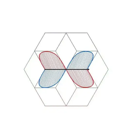

enter image description hereUsing a cube as a visual you can apply the electromagnetic wave interaction and reveal the relationship of it in space and time. You can see the both the 90 degree phase in space and -180 phase in time.
