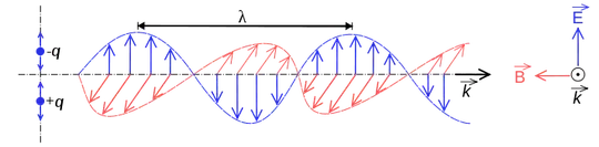

But there's more! Radio waves are electromagnetic radiation. Electromagnetic radiation contains of two components, one electrical and one magnetic. These components create each other, as said above. The red magnetic field creates a blue electric field, which creates the next magnetic field, and so on.
From the Electromagnetic radiation Wikipedia:
Electromagnetic radiation is a particular form of the more general electromagnetic field (EM field), which is produced by moving charges. Electromagnetic radiation is associated with EM fields that are far enough away from the moving charges that produced them that absorption of the EM radiation no longer affects the behaviour of these moving charges.

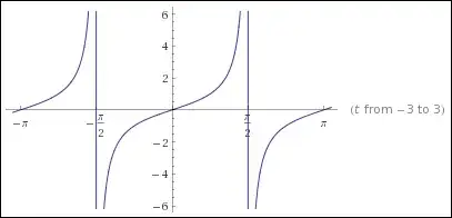

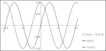

Think about the transformer. A magnetic field is generated when the current changes. Let's say we have a pure sine as the current, \$I(t)=sin(t)\cdot{}c\$. We can get the change of the current on a specific moment by taking the derivative of that sinus, which is the cosine, so: \$B(t)=cos(t)\cdot{}c\$. Now have a look at the functions \$I(t)\$ and \$B(t)\$, which should exist in "a constant ratio of strengths to each other" and in phase.
Note: the constant \$c\$ is because the formulas depend on other things as well, that are irrelevant now and constant in a specific situation
You can already see those functions aren't in phase. They aren't in a constant ratio to each other either. You can see that by plotting \$f(t)=\frac{sin(t)}{cos(t)}=tan(t)\$:
So no, a transformer does not radiate electromagnetic radiation. The waves aren't in a constant ratio of strength to each other, neither are they in phase. The tests you did with a transformer in your earlier question, were just based on a magnetic field.

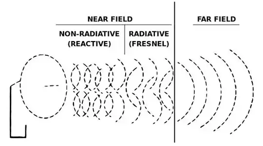

50/60Hz transformer coupling is not RF because it works by reactive field coupling in what is known as the "near field". Here's a picture from wikipedia on near and far fields: -
At about the wavelength of the antenna (or the frequency you are using to couple energy) the near field becomes the far field. The far field is regarded as "proper RF" and is able to propogate with it's radiation decreasing as the square of the distance.
Now consider a transformer at 50Hz - what is the wavelength - 6,000 km - will near field magnetic coupling work at even a 1,000m - no. It's not rf
