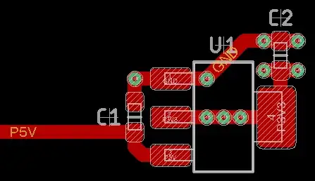

Consider the following simple layout problem: an LDO (LDL1117) in a SOT-223-4 package with input and output capacitors:
Let's assume a 4-layer board with GND and 3.3 V planes to which we can drop with vias. I would route this as follows (please feel free to critique - I am open to learning):
(Later I'd also pour GND on the top layer, which would "wash out" the GND trace from U1.1 to C2.)

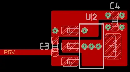

But when I look at "professional" designs, I more often see something like this (again, critique welcome):
I can think of the following pros/cons:
  • Higher current-carrying capacity with the polygon areas with less temperature rise.
  • For higher frequency signals, lower loop area since the current has more area available to seek the lowest-impedance path.
  • Solderability - I think the polygon areas will increase heat sinking and make it harder to hand-solder (more heat required). I'm not sure if there is any impact with professional reflow / wave soldering processes.

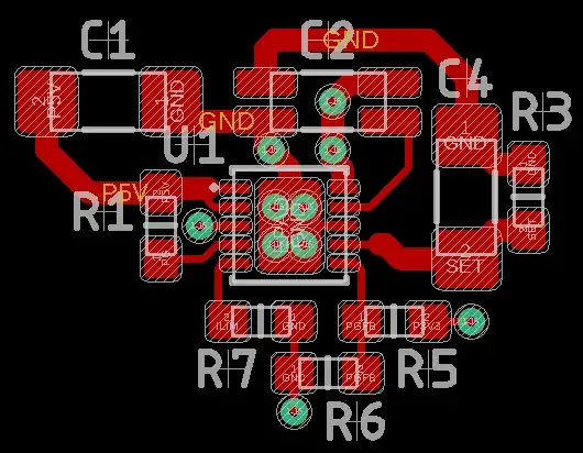

Let's look at a more complex example, this time using the ultra-low-noise, ultra-high-PSRR LT3024 LDO. The evaluation board has the following layout1:
I can reproduce this in EAGLE, but it's such a pain that I find myself wishing I could just do this2 instead (this is my mockup, and my reference designators match those of the evaluation board):
So just how much am I sacrificing if I choose to be lazy and use traces instead of polygons? If I have a relatively low-frequency, low-current (< 200 mA in the LT3024 example) circuit, does it really matter? Why, or why not?

That's why you have a big polygon with a lot of vias in it under the package. For the input and output pins, the datasheet doesn't have any special notes on it, though some do. 200mA is small enough that you wouldn't have to do anything special with trace width in terms of current carrying, but connections to filtering or decoupling capacitors should be low-impedance. Increasing trace width lowers the impedance, which is also why I suspect SET has a polygon on it. Of course, polygons generally have variable effective width as you traverse them so the resulting variations in impedance may not be desirable.
In general, I would start by looking very closely at the datasheet for whichever part is in question. Your LT3042 has a note to look at the DC2246B's datasheet for layout details, which is where you can see the split capacitor layout for C2. Then, I would see if any of the big manufacturers have white papers or app notes regarding layout of the type of component. For example, there's lots of generally-applicable information about switching regulators which are arguably much more picky about which polygons go where.
