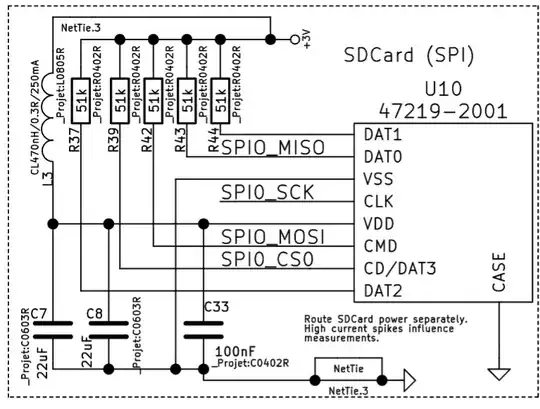

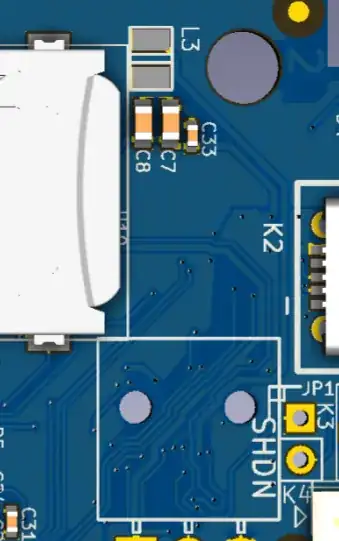

However, there is one case where I added a dedicated trace for decoupling, and it was actually a "low frequency" issue.
I had a circuit using an SDCard used to store the results of several measurements. As far as I remember, tthe SDCard was disturbing the circuit when it was switched on caused disturbances on the measurements where we were looking for very small changes in the values.
So I ended up adding a bead, and a nettie to be able to route separate VCC and GND traces up to the SDCard directly from the LDO's output. Powering the SDCard
You can see the adjacent traces on the PCB, the GND trace running up to C33 and the VCC trace up to L3.
Separate power traces
The LDO is on the other side of the board in between the two holes on the left of "SHDN" in the white square. It's from that area that the traces lead up to the SDCard.
IHMO this was a low frequency "bulk" capacitor issue rather than a HF decoupling issue.
