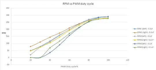

Edit 1: @Marko I did some characterization of my motors today. Thought I would post it here in case anyone might find it useful. The results are shown below. It seems that with proper capacitance tuning, I am able to get the motors to give almost similar responses. However, I believe there is still a need to use a control loop for better performance.
RPM vs PWM duty cycle
For example,if the left motor has a 0.3uF capacitor across its terminals while the right motor has a 0.2uF capacitor across its terminal, we can observed that the two response curve are very close together.
Another thing that I notice was that the motor would not move for duty cycle below 20%. And it seems like a universal problem with PWM control of DC brush motors... or at least I have not find any methods to overcome this behavior yet.

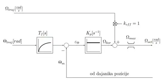

Usually a simple P,PI loop is better than bad PID loop. You can put 2 PI controlers for speed, for each wheel it own PI controller. Then you just control the speed of each wheel separately. Here is a small pseudo algorithm of PI controller with trap integration method: \$ u(k) = K_p \bigg[ e(k)-e(k-1)+\dfrac{T_s}{2T_i}\big[ e(k)+e(k-1)\big] +\\ +\dfrac{T_d}{T_s}\big[ e(k)-2e(k-1)+e(k-2)\big] \bigg] + u(k-1) \$

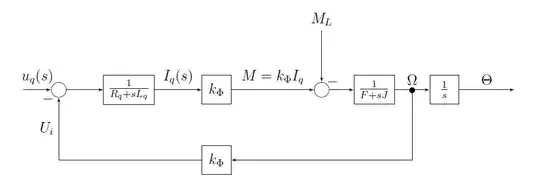

EDIT 1: enter image description here This is a block diagram of PMDC, notice that at the output there is an integrator \$\dfrac{1}{s}\$ that integrates the speed \$\Omega\$ into position \$\Theta\$. It matters if your controller uses speed or velocity feedback (or both). Since the veloctity feedback is obtained derivating the position, that's how is usually done, you can use PI, else a P controller is enough good, but it will give you I like response of the entire loop P->integrating->I. Using PD will give you PI like response PD->interating->PI(IP). You should decide wheather you will use velocity or position as setpoint. Professional equipment uses combined period and frequency measuring for estimating the velocity feedback information from position feedback, so simply derivating the position will give you bad result at low speed.
IMO you should start with making a setpoint velocity generator with ramp, then integrate into position setpoint and use position as setpoint.
\$ v_{set}(k)= v_{set}(k) + \Delta v_{max}\$
\$ p_{set}(k)= p_{set}(k) + v_{set}(k)\cdot T_{sample} \$ integrating position
This integrating position should be exactly the same size as your counter, for example 32-bit integer, so you have to parse it in integer form. When it will roll over, this won't affect the calculation of the error: \$\varepsilon = p_{measured} - p_{set} \$
