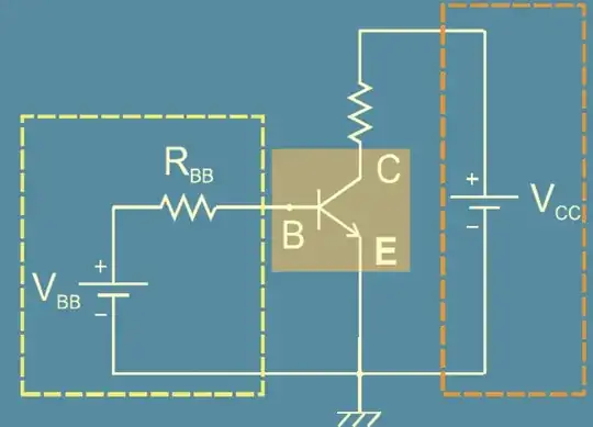

Take the following bias circuit:
Bias circuit for a BJT

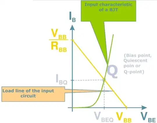

The input characteristic curve of a BJT is something like this:
Input characteristic curve of BJT

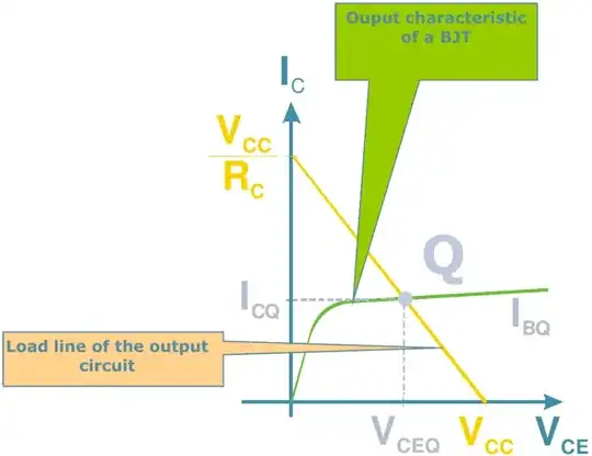

If we are looking for class-A linear amplification, then it is only logical that the Q-point (which must lie on the input characteristic curve) should be roughly midway inbetween its two extremes of operation with respect to it being 'fully ON' or 'fully OFF'. That is, they are where the curve is 'most linear', and we will get more faithful amplification. Also, we must ensure that in the output characteristic curve for the transistor, we will be far away from the saturation region:
Output characteristic curve of BJT

There is another line drawn in the previous two graphs: the load line of the input and output circuits. It is fixed by the values of \$V_{BB}\$ and \$R_{BB}\$ in the input circuit and by the values of \$V_{CE}\$ and \$R_C\$ in the output circuit. Here are their equations:
$$ \boxed{I_B} = \frac{V_{BB}-\boxed{V_{BE}}}{R_{BB}} $$
$$ \boxed{I_C} = \frac{V_{CC}-\boxed{V_{CE}}}{R_{C}} $$
where the boxed variables are varying throughout the lines.
So, in order for the biasing of our transistor to be appropriate for the purpose of class A linear amplification, we should regulate those voltages and resistances so that the load lines intersect the characteristic curves at a convenient place for the Q-point.
The typical exercise (like this one) in electronics courses about finding the Q-point of a BJT bias circuit is not really asking about finding the optimal voltages and resistances of the bias circuit for the transistor to operate as a class-A amplifier. In other words, it is not asking you to calibrate the load lines so that they intersect the characteristic curves at a convenient spot. Rather, they are asking to find the values of all the voltages and currents in the transistor given a specific set of bias circuit voltages and resistances. The circuit that they are providing is already biased to a given Q-point. What they ask of you is to find what that Q-point is.
In other words, 'find the Q-point of this transistor' does not mean 'find the optimal way of biasing this transistor', but rather, it means 'find how this transistor has been biased'.
