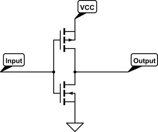

Using CMOS, the natural configuration is an inverter:
A buffer is always two inverters, especially with CMOS. So, if you're wanting to save transistors on something like an original 8086 you'll make your bistable memory cell out of inverters because they're cheap. Making it out of buffers would be redundant, because you'd be using 4 inverters instead of just 2. And if you're depending on the behavior of unbuffered inverters (useful appnote), it might actually not work for the application.

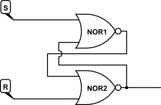

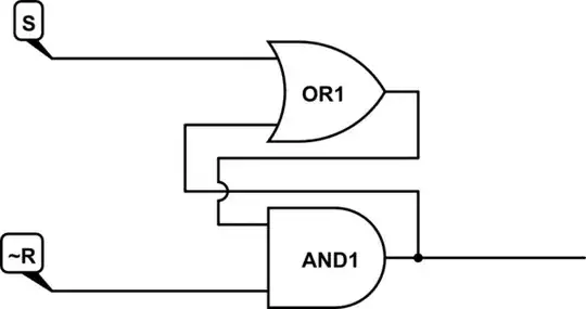

This is basically because it's hard to make non-inverting gain elements and easy to make inverting gain elements.
sure you can make a bistable like this.
but making usable and or or gates without internal inverters is not practical.
so regular bistables end up like this
simulate this circuit
