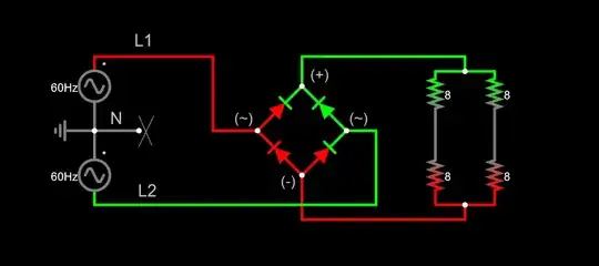

Yes, you'd run AC L1 and L2 to the rectifier "~" terminals and the kiln elements to "+" and "-". You do not need (or want) to connect neutral. And, do not connect the heater element to safety ground: that is unsafe!
(I'm not sure what you mean by "kiln is only pulling 100 volts". Do you mean watts? And it would be up to 12kW if it's on a 50A circuit. MORE: ok, there is an SCR chopping the AC to a bit less than 42% of full power. This could interact with the rectifier you propose, but probably will still work.)
Here's a related question about SCRs controlling heaters: How to use SCR to control the power of a heater. I suggest you study this and understand better how your controller works before you try this.
Say you wire up the rectifier. It will not be putting out smooth DC. Instead, it will be pulses at 2x the line rate, and when applied to the heater it will do practically the same thing as AC. That is, elements will emit heat that has a small 2x line-rate ripple element to it. The heating element ends will be swinging from 0 to +165V (+) and 0 to -165V (-), respectively, vs. +/-165V for both ends when using straight AC.
Here's a sim showing that (simulate it here)
Given more time we could simulate it with the SCR chop.
You could smooth the ripple by adding capacitors. Then you will be left with having a DC bias across the element. Then this can test your AC power hypothesis. I'd be leery of this however, as this will interfere with the SCR and possibly damage it.

Here's the schematic.
The bridge rectifier is to be mounted on an appropriate heat sink. The heat dissipated would be about 100 W.
Silicone heat sink paste is to be applied between the rectifier and the heat sink.
The output RMS voltage would be 240 V minus the diode forward voltage drop of 2 V.

Yeah, that will probably do. Connect L1 and L2 to "~" and elements to +/-. The same power will flow (minus a couple volts), and the same controller (thyristor / phase control?) will do.
Note that fuses do not function on DC, or rather, special types are required to break DC. If the element is fused directly, move the fuses ahead of the rectifier, on the AC side. They will work normally there. Probably, the fuses are in the controller, and this is no problem at all.
Note also the rectifier requires heatsinking. Mount it on a heatsink capable of dissipating about 100W. Shop for this, or a temp rise of 1°C/W or less. Drill and tap holes in the heatsink (if not already on centers for the device), and use thermal grease in the joint between device and heatsink. Place the heatsink in an area with free, cool (ambient) airflow. Place guards over the connections, and probably connect an electrical grounding lug to the heatsink for safety.
