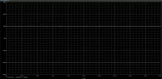

I made this current sink to discharge a 9 V battery. Is this okay?

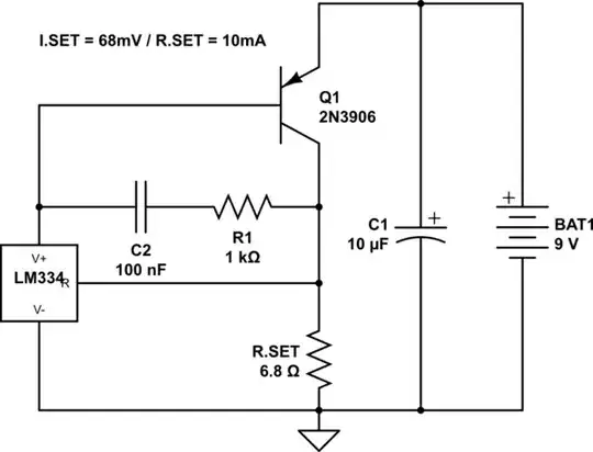

I would use an LM334 and a PNP transistor. The circuit will operate down to about 1.8V:
schematic
For a bit more commentary on the basics of this idea, see this article.
Q1 takes the thermal dissipation away from LM334, and ensures minimal thermal drift. Recall that LM334's thermal voltage varies by 0.227mV per Kelvin.
The battery's internal impedance rises as the battery discharges, and C1 is necessary to stabilize the AC impedance, so that the regulator can operate in the same stability conditions throughout the discharge.
R1 and C2 are optional for stability. The battery is a constant voltage source. The step response and settling time of this circuit are only of secondary importance.
To tweak the values, connect a function generator set for 50 Ohm load, square wave output, 1kHz, via a 100uF DC blocking capacitor to the battery. This will add a "saw" waveform on top of the battery voltage. Add a current-to-voltage amplifier in series with the battery. This lets you adjust the compensation components for best current settling after each disturbance.
