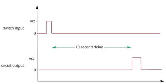

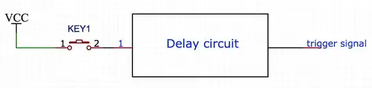

I wanted to make a circuit in which a push button is pressed once and then the system should wait for a small period of 10 seconds and then give an output pulse of a second. I am looking for a cheap alternative by using analog circuits rather than using a microcontroller. enter image description here enter image description here

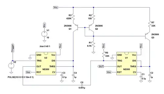

You can do this with 555 timers as others have said (you could also do it with discrete transistors) the biggest problem being the capacitor values needed for relatively long time delays.
You can get around that problem by using constant current sources to feed the capacitors.
This is a general idea of how that would be done.
V2 represents the switch input, you would need to have the switch generate a negative going pulse. This answer gives an idea how to do that, but you would probably need to remove C1 to keep it from triggering on power up.
The two timers use 1 uF capacitors, these could be something like film or ceramic types. The capacitors are charged by current sources made up of transistors Q1 to Q3. R3 and R7 (along with R1 and R2 to some degree) set the charging currents for each timer. 10 second delayed pulse  schemtic

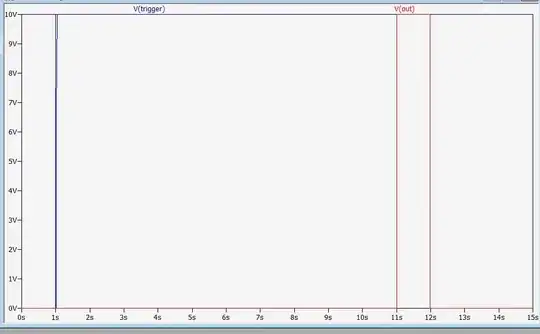

The blue is the trigger pulse, the red the output occurring 10 seconds later for 1 second.
10 second delayed pulse waveforms
You would of course need to adapt it to your own needs, adding the switch circuit, an output driver, and possibly make the timing resistors adjustable.

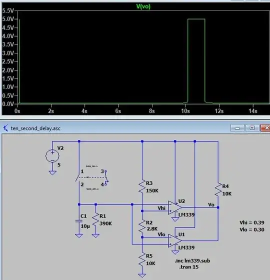

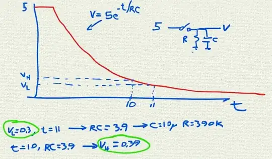

Circuits with microprocessors or digital counters will give the most accurate results but you asked for an analog solution.
Assuming this is a one-off hobby project and your requirements are somewhat coarse, you can probably get the following simple circuit to do the trick.
An RC charged to 5V will discharge exponentially to zero. If we make that exponential discharge time long, over 10 seconds, then we can set up a threshold comparator to trigger as is passes the 10 to 11 second time window.
If we choose the low threshold to be say, 0.3V, then the rest of the values are easily calculated.
The LM339 is a cheap, dual part so this is a one chip solution. The output of each comparator goes high (open collector actually) only during the window where the discharge voltage passes between the two theshold voltages.
The discharge voltage is passing very slowly across the comparator thresholds so there’s a chance for a brief instability (oscillation) at the transitions, so not a good choice if you need a clean pulse. This is solvable with some hysteresis but at that point the complexity is getting ugly enough you may as well use 555s.
Another reason this is only suitable for a “one-off, hobby” situation is that the tolerance of large capacitors is not good. If the cap is off by 20% then your 10 seconds will come out to 8 seconds. But since this is a one-off project it’s just a simple matter of futzing with the Vlo and Vhi comparator thresholds to get any trip points you desire, within reason.

    Simulation shows a super-narrow blip when button is pressed. This is due to C1 crossing up through the transition window as it abruptly charges. This may not happen in real life, or be benign in the application, but in any case is easily squelched with a 100p cap from Vo to ground. – td127 Jun 16 '22 at 22:30

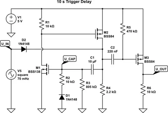

Solution with discrete components
schematic
Just for people, who don't want to see NE 555 in each circuit.
  1. D2 and V5 just simulate a long pressed button input
  2. When the input is active M1 and M2 immediately conduct, U_CAP will be 5 V
  3. R3 charges C1, U_CAP is falling for 10 s until current through M1 is falling
  4. M2 and M1 quickly turn off, U_CAP is below GND, the voltage across R4 is near zero
  5. The falling edge turns on M3 via C2, start of the output pulse
  6. R5 charges C2 and R2 discharges C1
  7. M3 turns off after C1 is charged, end of the output pulse
  8. After about 500 ms (C1 discharged) the circuit is ready for the next cycle
