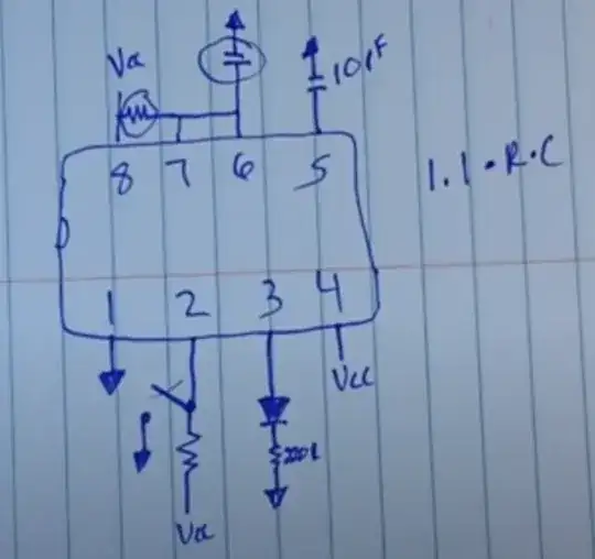

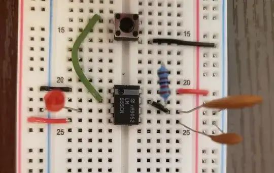

I am very new to circuits and I've tried everything online but nothing seems to be working. I am making this circuit for a class.
I am trying to emulate this circuit diagram from this youtube video with Vcc set to 5V.
LED is in place of servo switch leg
I am trying to use the 555 timer to send a signal to a small RC servo motor. I have set up the 555 in monostable mode with a momentary switch. The problem is that the switch sends a signal to the output that will not stop unless the switch is depressed.
With the short pulse width requirement of the servo, the output signal from the 555 is corrupted from the output from the momentary switch so long as it is pressed. With the servo connected, it will move sporadically back and forth, but will not complete a 60 degree cycle. I have tried connecting a 10k resistor from 2 to +, but this had no effect. The resistor connecting 7 and 8 is just for this example; I'm actually using a potentiometer to set the timing. Any help would be greatly appreciated.

  • Do you also have the schematic on which the breadboard assembly is based? (Hint: post it!) – JYelton Apr 21 '22 at 20:36
  • You need to provide a schematic diagram. You do need the resistor from 2 to + but you also need to limit the current through the LED. You are missing the series resistor there. You might also mention the supply voltage. – Transistor Apr 21 '22 at 20:39
  • Original post has been updated. I did try with the resistor connected to 2 and + but it made no difference in the circuit performance. – try_hard Apr 21 '22 at 20:41

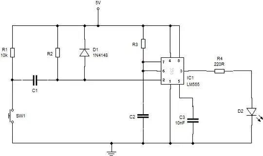

555 timer one shot circuit
The standard way of circumventing this common problem is to add an RC differentiator to the pin 2 input. The differentiator consists of C1 & R2.
When S1 is pressed, the left hand side of C1 goes to 0V. The right hand side of C1 must instantly follow. The voltage on the right hand side of C1 then rises exponentially to 5V as C1 charges through R2. When S1 is released, C1 discharges via R1, R2 and D1 ready for the next switch press. The reason for having D1 is to prevent the voltage at the pin 2 input rising to more than about 5.6 V when the switch is released. This protects the pin 2 input from damage.
The result of all this is to generate a short pulse into pin 2 when the switch is pressed.
The pin 3 output will be high for a time period equal to 1.1 * R3 * C2 but for this to be true pin 2 must rise above 1/3 * Vcc before the end of the output pulse otherwise the output pulse will be extended.
And so, 1.1 * R3 * C2 must be greater than 0.4 * C1 * R2
I have specified a value of 10 nF for C3 which is a more typical value than your 10 pF.
