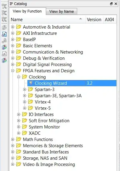

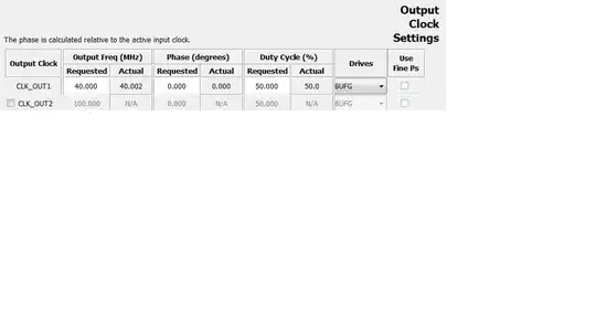

I would rather suggest using Xilinx primitice digital clock manager IP.
It has graphical settings interface where you can specify what frequency you want. It will generate a component with your desired output as frequency.
It can be found in IP Wizard;
And then you will be able to specify what frequency do you want: enter image description here
