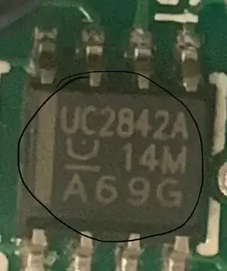

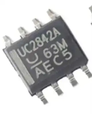

I need make replacement any problem will happen to circuit.
Both ICs are UC2824A but the difference is the last two lines on the IC.

I didn't see anything in the Texas Instruments datasheet about those being feature codes. Usually, one of those two lines is a code for the manufacturing date. The other could be a code for the plant location.

  • Thanks for your reply , It means no any problems comes if I remove one and install other – mahmoud hussein Mar 16 '22 at 12:36
    The device marking has a footnote: "There may be additional marking, which relates to the logo, the lot trace code information, or the environmental category on the device.". It isn't further specified, but shouldn't be of any importance. – Velvet Mar 16 '22 at 13:04
