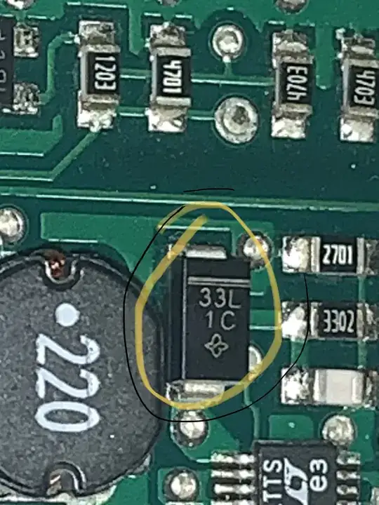

I have an electronic card for DC charger. Please help to identify the component marked 33L 1C in the photo.

  • The IC marked with the LT logo and the coil to the left suggests this diode is part of a switched DC/DC converter circuit. If that diode is blown, then you should replace the LT regulator IC as well. Whenever the regulator blows, this diode tends to blow too, and vice versa. If you only replace one of them, it might blow up yet again. – Lundin Mar 16 '22 at 15:39
The diode appears to be an SSA33L. Datasheet is here:
Vishay SSA33L Data Sheet
The marking is designated as "33L":
