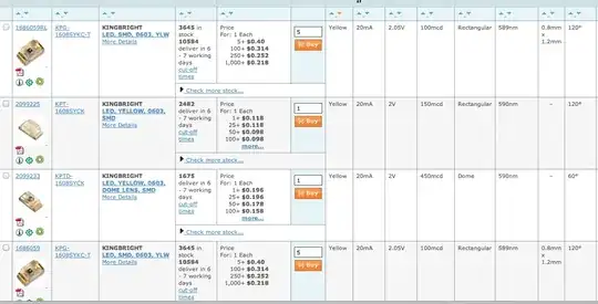

I did a search for 0603 sized high brightness Kingbright LEDs on element14, results are here .
Why is there such a range of luminous intensity, even within the same colour, despite forward voltage, forward current, size and viewing angle being the same?
I am using the LEDs as indicators in a very low power battery powered device. The LEDs will be pulsed at times to give user feedback. Would the LED that gives the brightest output be the one that gives the highest luminous intensity, or is there another consideration?

  • Thanks Olin, the first part of the question is more to do with why some LEDs have different luminous intensity (candela) when shape, Vf, If, lens, etc. are the same. I guess it could be explained by chemistry but some even have the same chemistry and different luminous intensity. – geometrikal Mar 16 '13 at 04:35
  • P.S. the purpose is to choose the LED that will give the most 'visible' feedback, in the form of a flash, for the lowest power. Maybe I should put that in another question though. – geometrikal Mar 16 '13 at 04:36
