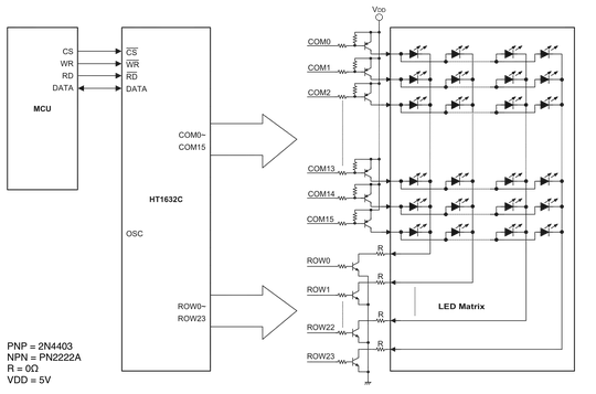

As my goal is to obtain the same brightness with my matrix than a continuous mode 5mm LED, I decided to try with more powerful LEDs and so I get SMD 5050 (PLCC6 3.1V 60mA) ones, using all of the three modules inside of them. I changed my shift registers for an HT1632C which is a dedicated component for LEDs matrix driving.
I followed instructions from HT1632C datasheet, especially the following diagram :
The results were more or less the same than the first ones (I succeeded in getting more brightness due to 5050 but not enough to reach continuous 5mm). So I decided to do several tests by connecting LEDs to 5V through resistors (to aim to get nominal current through them), and then without these resistors. I noticed a slight difference concerning the brightness but not so much.
I chose to come to you because It starts to drive me crazy. I may have missed something obvious ? Probably … !
I don't know what is the usual way of doing this, for example if LEDs can be overcharged without risks (because they are pulsed) or something else ?
In brief, what I'd like to get is a 10*11 SMD 5050 LEDs matrix which permits to get almost the same brightness as 5mm LEDs in continuous mode.

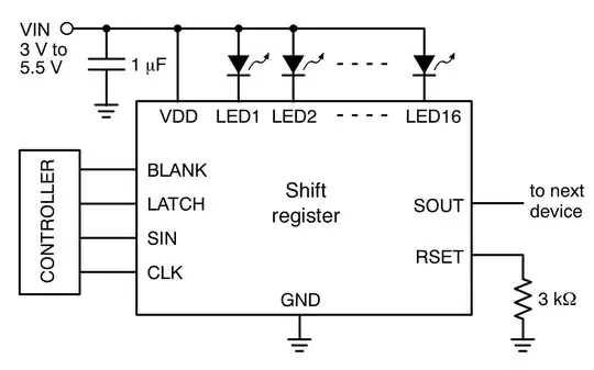

It seems impossible to get more luminosity with matrix multiplexing without largely excees the characteristics of LED. To obtain sufficient brightness, I plan to use shift registers with integrated LED driver such as TLC5940.
Each LED will be connected to an output of a register (cf. diagram). However, to drive 110 LEDs, it takes at least seven registers (in chain). I think this a "brute force" solution and I wonder if chaining many registers will not generate problems.
