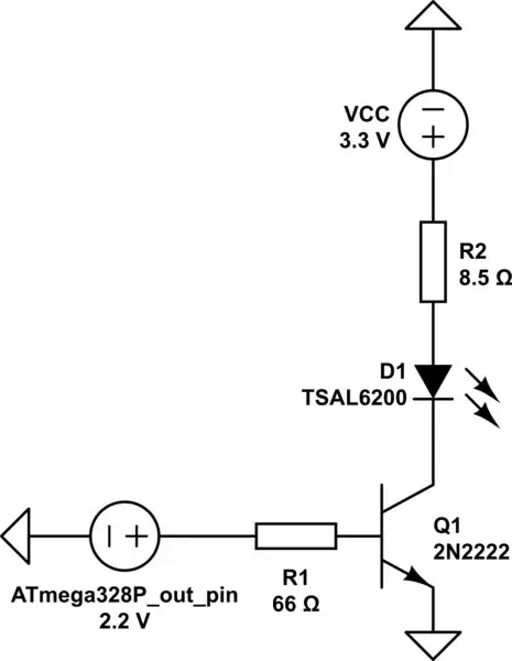

I want to use a high power IR LED such as a Vishay TSAL6200 with a 3.3V ATmega328P. Since an output pin of that MCU can provide 'just' up to 20 mA I can't directly connect that LED but have to connect some transistor circuit. So the goal is to drive the LED with 200 mA, under a 38 kHz PWM scheme (say, 23 % to 50 % or so duty cycle).
What I figured from reading up on transistors is that in order to use a transistor for on/off switching I should saturate its base.
The 2N2222 transistor seems to be a common choice and allow for sufficient switching power. And it should be saturated when the base (I_B) is powered with 1/10 th of the collector power (I_B). Thus, for my use case, I_B should be 20 mA, right?
Looking at the ATmega328P output voltage figures (Figure 35-23, page 608) I understand that I should use V_OH (i.e. 2.2 V) when calculating the base resistor. Ok, the figure is for VCC = 3 V and not 3.3 V but perhaps this is close enough. Is this a fair approach?
Also, when computing the base/LED resistor values, I understand that I should subtract the voltage drop in the transistor. Looking at some datasheets/posts I think the drop is 0.6 V for that transistor.
So in my calculations I'm using the following variables:
VCC       =  3.3 V # circuit voltage
I_LED     = 200 mA # TSAL6200 LED peak forward current
I_B       =  20 mA # 2N2222 transistor base current
V_F       = 1.45 V # LED forward voltage
V_OH      = 2.2  V # ATmega328P output pin voltage at 20 mA
V_BE(sat) = 0.88 V # Base/emitter voltage drop at I_C=0.2 A when saturating
V_CE(sat) = 0.15 V # Collector/emitter voltage drop at I_C=0.2 A when saturating
So I arrived at this schematic:
schematic
I calculated the resistor values like this:
R1 = (V_OH - V_BE(sat) / I_B = 66 Ohm
    => P1 = (V_OH - V_BE(sat)) * I_B = ~ 0.03 W
R2 = (VCC - V_F - V_CE(sat)) / I_LED = 8.5 Ohm => P = (VCC - V_F - V_CE(sat)) * I_LED = 0.34 W
See also an onsemi 2N2222A datasheet (i.e. Figure 2 and Figure 3 on page 3) for the used transistor parameters.
My main question regards power efficiency of such a circuit - can it be improved?
For example, is there perhaps another transistor part which saturates at lower current and thus would save some energy?
Is leakage current (when the output pin connected to the base is low) something to worry about? Or do such transistors usually have low leakage current?
Or are there more power efficient IR LEDs?

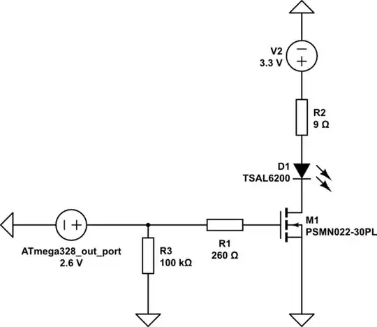

I sketched the Mosfet circuit like this:
schematic
simulate this circuit
Design notes:
  • The purpose of R1 is to limit the gate current to 10 mA in order to reduce RF noise when discharging and possibly other weird effect. Its value is smaller than the recommended 330 Ohm since the voltage at the ATmega328P output pin drops to 2.6 V when 10 mA is consumed from it.
  • R3 is a pull-down resistor to avoid that the gate is in a undefined/floating state during microcontroller reset.
  • the source of the Mosfet is connected to ground and the load is connected to the drain, the only useful configuration for such a Mosfet, as I understand
  • R2 protects the LED such it's limited to 200 mA (i.e. R2 = (VCC - V_F) / I_LED - R_DS(on) = (3.3 V - 1.45 V) / 0.2 A) - 0.04 Ohm)

  • In your calculation for R2 (marked R3 in the diagram!) you use V_drp this is the base-emitter voltage. What you should use is VCE_sat at the given I_B and I_LED taken from the data sheet of whatever transistor you are using. – Peter Jennings Feb 12 '22 at 22:29

    @maxschlepzig The 2N2222 is a generic part made by many different manufacturers. There is a basic JEDEC specification that any such transistor must meet in order to be sold as a 2N2222, but I guess that there are tolerances specified and some parameters not defined at all. See https://en.wikipedia.org/wiki/2N2222. Hence there are going to be differences between batches of 2N2222s made in different plants or even at different times in the same plant. – Peter Jennings Feb 20 '22 at 22:54
Select an N-channel MOSFET with a logic-level gate voltage instead of the BJT.
That requires no static gate current in place of the fairly high base current you have for the your circuit.

Update now PSMN022-30PL MOSFET added to question
The PSMN022-30PL is a good choice. Fig. 6 of its datasheet shows ID of 7.5 A with a Vgs of 3 V, a lower Vgs than your circuit will drive.
The ATmega328P datasheet Fig. 29-9 on p271 shows its I/O pin HIGH output current to be VDD-0.5 V worst case when IOH is 10 mA. IOH(max) is 20 mA so a 220R gate resistor would draw 11 mA at the same 2.5 V when the gate is discharged.
As the gate charges, the voltage across the series resistor falls and so does the drawn current. This means the gate voltage will approach something like VDD-0.15 V (stretching that graph's precision a bit) if there's sufficient mark time in the frequency cycle. It'll be a better case when discharging.

  • I've updated my question with an updated circuit that uses a concrete Mosfet. I've also described my selection process. To limit the current at the gate I used 260 R instead of 330R since there is a voltage drop at the output pin when drawing 10 mA (according to the ATmega328p datasheet). Is this a valid design decision? The selected Mosfet has Q_G=4.4 nC - thus, I figured that it loads and thus switches in 0.4 µs, correct? – maxschlepzig Feb 14 '22 at 00:09
    @maxschlepzig, I've updated my answer as per your question change. For the gate pull-down resistor, it's better to have that on the I/O pin, not the gate, to not create a potential divider (less important here but good practice in most MCU circuits). Look up the right figures but assuming I/O pin leakage of +/-10 uA max. leads to a 33K pull-down producing 0.33 V max on the gate and only 100 uA draw if I/O pin was 3.3 V. – TonyM Feb 14 '22 at 14:22
  • Ok, I moved the pull-down resistor in the schematic. – maxschlepzig Jun 19 '22 at 21:17
