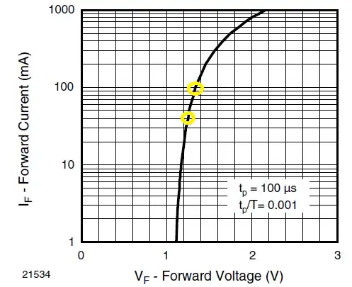

Let's look at Figure 4 from your datasheet:
I've circled two locations in yellow color. This shows that you can typically expect about \$\le 1.3\:\text{V}\$ when driving the LED.
