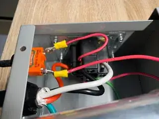

Bought this on Amazon as a dryer 240V SPD. I was trying to find out if this device is an outright scam. I found a similar post on here from several years ago but that did not answer my question. Apparently this device was originally sold as a "power recovery device," but it appears they rebranded them as dryer surge protectors. Decided to open up the one I bought to see if it even had MOVs inside.

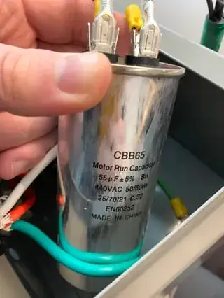

All I found is this giant capacitor.
  • Is this literally a capacitor with a switch that turns on a light?
  • Would this capacitor provide any surge protection in either direction?
  • Might it prevent the dryer from creating a surge?

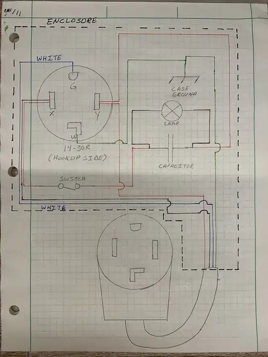

enter image description here My best attempt at a schematic. Wire colors are correctly represented, blue is "white" and marked as such. Terminals are as marked on the receptacle.

    The label: "suitable for wet locations." I think not. – Andrew Morton Jan 25 '22 at 19:56

  • Is it safe to hold a large cap like this? – Eric Duminil Jan 26 '22 at 06:36
    The electroncis in the dryer should already be very well "surge" protected as the control board has to operate inside a box with a large motor, several solenoids, as well as moisture & heat & humidity... anything you put externally to that is likely to have almost no benefit, it's like erecting a wooden fence outside a castle wall to protect the houses inside. – John U Jan 26 '22 at 14:56
    @jason-p, Just for the curious among us, could you make a schematic for this box? I have a couple of questions, such as how is neutral connected? and how is the capacitor connected (L1 to L2 or L1 to N?). – hacktastical Jan 26 '22 at 15:34
    @EricDuminil A responsible manufacturer would have put discharge resistors on such a capacitor. I can't see any in the photo. – Andrew Morton Jan 26 '22 at 18:18

  • @AndrewMorton no there was nothing else in the box except the capacitor. It had been unplugged for a couple days before I opened it up but yes probably something to be wary of. – Jason P Jan 26 '22 at 21:51

  • @hacktastical Schematic added – Jason P Jan 26 '22 at 22:57
    Looks like ground and neutral are swapped on the receptacle. D-shaped pin should be ground, L-shaped pin should be neutral. If it’s really like that… oy. – hacktastical Jan 27 '22 at 00:31
  • To emphasize, there should be no connection between neutral and ground on a 14-30R receptacle. Neutral (white) should only connect through. – hacktastical Jan 27 '22 at 00:42

    @EricDuminil Assuming it's not hooked to anything else, it's safe to hold the case, provided you can reliably not touch the terminals. Including after it's been unplugged for a while. Some time back, I knew someone who touched the terminals of a (low leakage) photo-flash capacitor that had been off for a week; his scream was clearly audible at the other end of the house. You will want a discharge resistor. – Technophile Jan 27 '22 at 04:03
    The lamp wired across the capacitor provides a discharge path. Nonetheless, treat the cap with caution. – hacktastical Jan 27 '22 at 06:15

    Is the angled pin in the 14-30R actually connected to ground, while the ground pin is connected to neutral (white)? Or did you mix that up in your schematic? – FreeMan Jan 27 '22 at 17:58
  • @Freeman Yes the “L” socket terminal is actually connected to green / ground. And ground is connected to white. I thought that was odd when i looked at the back of the receptacle it literally says white but has green wires hooked up. – Jason P Jan 28 '22 at 01:38

  • @hacktastical If it's a neon lamp, could it leave something like 80 V across the capacitor? (The mfr might have got a cheap lot of ~something that glows~.) – Andrew Morton Jan 28 '22 at 22:18

This device is NOT a surge protector. While it may have been advertised as such on Amazon (there is not really any control about what vendors say there, so you're on your own) it's clearly labelled as a "Power Factor Correction" device.
Whether this does anything useful depends on your situation. Generally dryers are not really a problem with power factor as the majority of the load is purely resistive with the only inductive load being the small motor that drives the barrel.
Generally homeowners don't care much about PF anyway because in most places the power company doesn't bill residential customers for having bad PF.
So the bottom line is that this device will have little to no effect on "surges" and its impact on your PF is likely insignificant or irrelevant.

Like many scams, these boxes are based on a small kernel of truth. And that kernel is, applying a capacitor across the line compensates for inductive load influence on power factor. Properly sized (and connected, more below), a capacitor will reduce the dryer’s apparent power, which has a reactive component (the motor’s inductance).
Some background here: https://electricalacademia.com/basic-electrical/power-factor-correction/
So technically it could do something kind of useful, at least when the dryer is running and if its capacitor were connected correctly. Note the weasel-words ‘technically’ and ‘kind of’ and of course, 'if'. We’ll dig into this a bit.
It doesn’t do much of anything to protect against surges however, and being a capacitor, it’s vulnerable to them.

But the closer you look, the more dodgy this thing gets. The box wires the cap between L1 to L2 (black and red wires.) Dryers sold in 120V countries use a 'split-phase' arrangement, where the 120V motor is wired L1 or L2 to Neutral (white wire), while the heating element is wired between L1 and L2.
(Why? Gas and electric dryers sold in North America generally use the same 120V motor, saving cost and allowing them to be converted in the field. Gas dryers use a 120V plug, electric uses split-phase 240V.)
So the cap is not even connected correctly for a 120V dryer motor: any reactive cancelling it's doing is making its way all the way back to the opposite phase, to the utility pole, then back to neutral.
And even worse, as @Peter Green points out, having this capacitor across the line all the time, even when the dryer isn’t running, actually uses apparent power, working directly against the goal of optimizing household PF. Instead, it should be placed on the motor itself, sized appropriately to give the correct phase shift, and only switched in when the motor is on.
(Ed note: the box has a switch for the cap. You would need to remember to flip it on whenever you start the dryer, then flip it off again when the dryer stops. Not very practical.)
Finally, I see no UL approval on this thing. If it catches fire, and your insurance finds out about it they could use it as a basis to deny your claim.
Like I said, I’d disconnect it at once, and return it to Amazon if you can.
