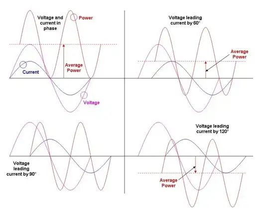

Analogue meters measure the average value of the instantaneous values of current and voltage multiplied together: -
  • power = Average(v x i)
  • energy = integral(v x i)
Power factor is irrelevant because there is only one way to measure power and that is how I have stated it.
Trying to "use" power factor, RMS voltage and RMS current in order to calculate power is a fruitless task given the number of harmonics present in many current waveforms.

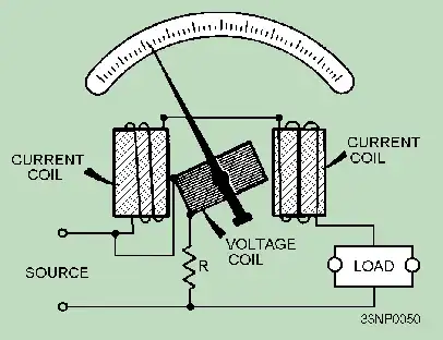

A moving coil power measurement device (aka the dynamometer): -

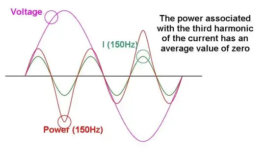

Just in case there are any doubts that the power measurment method can cope with harmonics of current take a look at this: -
Here we have voltage at 50Hz and a common harmonic (3rd) of current at 150Hz - see that the instantaneous waveform of power has zero average, just as it should do.
