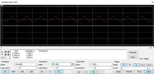

I tried to simulate this oscillator in Multisim, but it doesn't work, I get just DC voltage from it. With the same biasing I got to make it work, but on lower frequency (around 1 MHz), while I want to get it around 100 MHz from it. Do you have any idea why does it not work? I know results from simulators are often different from real life, but I don't want to order the components, and try it out at home if I know that my design is junk. enter image description here
Edit: I tried using my new design, and it doesn't work again. Input impedance is high, inductance is much higher than capacitance, it's biased as an A class Common Collector amplifier, and transistor should now support so high frequencies. What is wrong with my design?

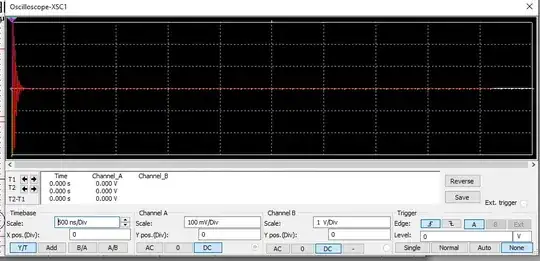

Edit 2: enter image description here
I decreased emitter's impedance, but it still won't work.
Edit3: enter image description here

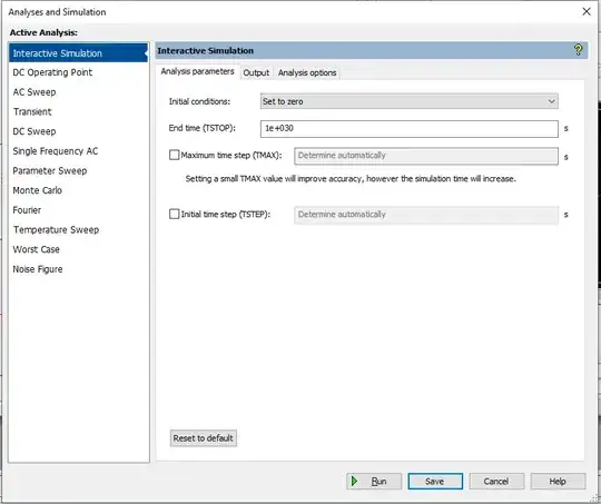

My transient settings.

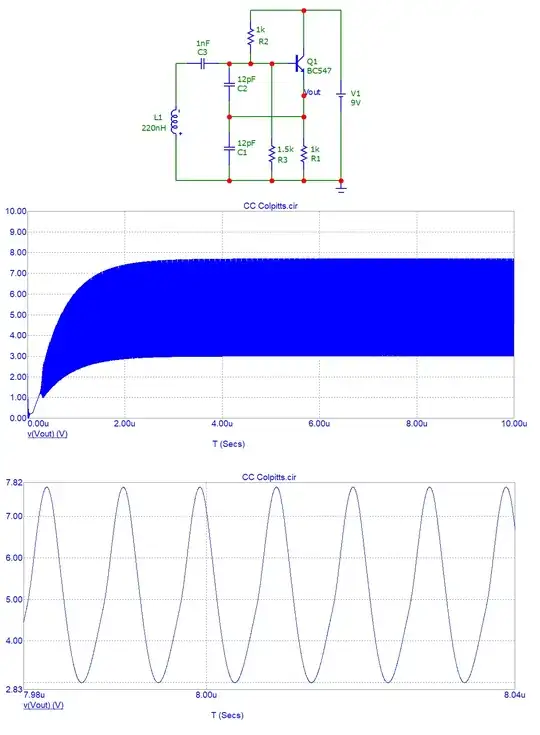

In one of your previous questions, I proposed this 100 MHz oscillator circuit: -
As you can see, L1 is about ten times what you are using and C1 and C2 are also much smaller than what you propose in your circuit. You also need to use a transistor that has got a decent β into the GHz, possibly a BFR90 to get results that are close to the formulas.
In my simulation above, I got 100.6 MHz but that was with a BC547. Theoretically it should be around 140 MHz (from memory) and, to achieve this you'll need a much better transistor or, live with the discrepancy between reality and formula.

  • I tried simulating your circuit and it works of course. But the weird thing is that I had to connect 100MHz generator to transistor first to make it oscillate, and when I opened the generator's switch, it kept oscillating. Now every time I stop and start simulation again it works. Just like if I had to tell simulator what is it about. – Pavle Hribar Jan 19 '22 at 19:14
    @PavleHribar - oscillators in simulation often require kicking at startup. You may be able to modify the startup conditions of the simulator or intentionally provide a pulse to start oscillation. In the real world oscillation will start from noise that may not be present in the simulation. – Kevin White Jan 19 '22 at 19:36
    My sim (micro-cap) has the option to start right from a cold start i.e. "disable start from operating point" - if your result doesn't show the proper start up of the waveform (as per my middle picture) then you need to locate the "switch" that forces a cold start. If you don't have the operating point start disabled, it tries to find the natural dc conditions after everything has settled down then applies those before starting the circuit transient response and, that does (or can) cause problems. – Andy aka Jan 19 '22 at 20:51

  • I decrased emitter's impedance as you can see in edit 2, but it still won't oscillate. Why? – Pavle Hribar Jan 20 '22 at 21:42
  • Have you set your simulator to run from cold as I said earlier? Show your transient response starting from a cold start and for several micro seconds as per my middle picture (as I've said before) @pavleHribar – Andy aka Jan 20 '22 at 22:53
  • Yep, I have initial conditions set to zero. See edit 3. – Pavle Hribar Jan 20 '22 at 23:12
  • I asked you to show the transient response (as per one of the pictures in my answer). You do need to listen. Also show the transient response when you used exactly the same component values as I did. – Andy aka Jan 21 '22 at 00:03
  • Sorry. I posted transient repondes in 4th edit. Oscillator is connected to chanel A in both cases – Pavle Hribar Jan 21 '22 at 15:23
  • That shows 5 us of nothing. Presumably you had the probe on the emitter. If you didn't why not? If you did then, something is wrong because you'd at least expect the emitter voltage to rise from a cold start to something like 5 volts as per my middle diagram (even when not oscillating). Instead of falling at the first hurdle, try thinking this through for yourself. You have your circuit and your sim and you should think harder as to what should be happening. I can't help you with your sim. I use a different sim. Try harder to figure this out. This site is not geared up for semi-live tutorials. – Andy aka Jan 21 '22 at 15:55
  • You were right. My design needed about 80us to start oscillating, and I got very fine sine wave from it. I replaced capacitors to 10pF and inductor to 500nH, but the frequency is a little higher than I expected from calculations - about 140MHz. However, thanks for help. – Pavle Hribar Jan 22 '22 at 12:15
