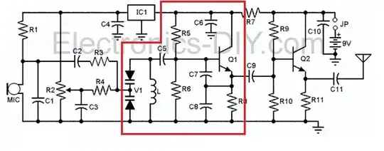

I have a hard time understanding how the oscillator works in this circuit. The oscillator uses varicap diodes V1 to change the frequency of oscillation.
But this circuit is very different from a standard Colpitts oscillator which uses two capacitors and an inductor. In a standard Colpitts oscillator the gap between capacitors is grounded, while it's connected to resistor R8 here. Why?
I actually don't even understand what the purpose of C7 and C8 is when the tank circuit is already formed by V1 and L. And a standard Colpitts oscillator has a tank circuit connected to the collector to make a transistor produce a 180 ° phase shift, but here it's connected to the emitter, so there's no phase shift.
I don't understand where it does get enough phase shift to make it oscillate.
How to find the frequency of oscillation?

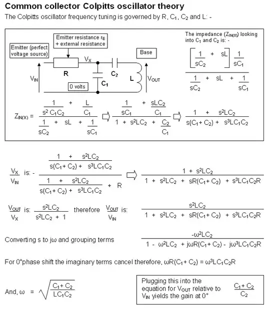

It's a bog-standard common-collector Colpitts oscillator: -
No, it's a standard configuration of the common-collector Colpitts oscillator. It uses two capacitors and an inductor (C7, C8 and L) with V1 tweaking the net capacitance and producing frequency modulation.

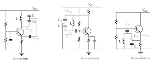

No, there are three standard Colpitts BJT oscillators and you just haven't come across the common-collector version. Do some research on Google. An example: -
Image of the three standard Colpitts oscillators taken from here.
The tank isn't formed wholly that way. You need to do some research as to why it relies on C7 and C8 and, the varactor V1 modifies things to perform FM modulation.
No, there are three standards and, it appears, that you have only been previously introduced to one of them. All three produce a 180° phase shift.

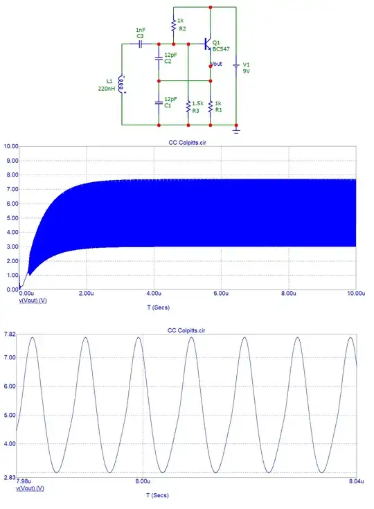

Simulation using BC547 - aiming for around 100 MHz
It's oscillating at 100.6 MHz.

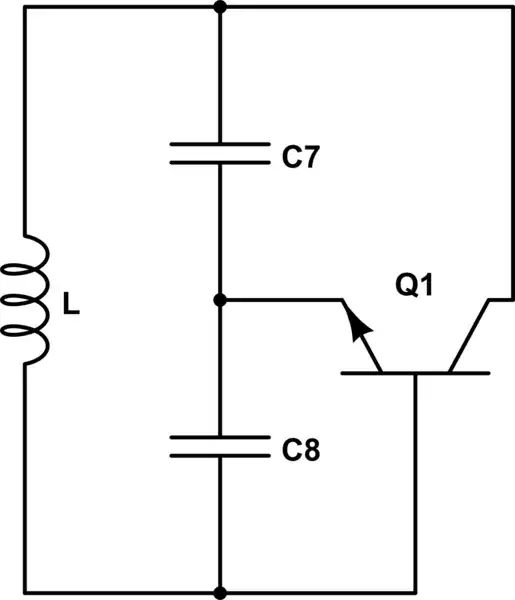

This is an awful lot like a standard Colpitts oscillator, you're just not thinking flexibly enough. To understand all the flavors of Colpitts, you need to first accept that "ground" is just an arbitrary thing that the designer chooses for convenience. At the core of any Colpitts is this*:
schematic
Note two things: first, ground isn't called out; second, there's no bias or power supply. To make this into a concrete Colpitts oscillator you first choose one of the transistor pins to ground, then you add bias and power.
Choosing to ground one transistor pin makes the oscillator a common emitter oscillator (which is what you seem to be used to), a common collector oscillator (which is what the schematic is calling out), or a common base oscillator.
In the case of this oscillator the collector is grounded for AC signals first because the power rail is ground for RF, and second because C6 carries the RF current from the collector to ground (and if the circuit is well laid out physically, will be close to Q1).
Make the thing actually work, R6, R7, and R8 bias the transistor into it's operating range, and R8 carries the emitter current to ground. C5 is added to prevent the coil, L, from shorting the base to ground (you'll may find that C5 has a significantly higher capacitance than C7 and C8, but it doesn't have to be -- way higher means the designer wanted it to act like a short circuit at AC; lower means that the designer was purposely choosing its value to influence the resonant frequency).
If you ignore V1, that's it -- you have a basic common-emitter Colpitts oscillator. What V1 does is to add some capacitance across the coil. This capacitance shifts the resonance frequency of the tank downwards, and because V1 is voltage-variable, that frequency shift can be adjusted electronically.
I would expect that as long as Q1's \$f_T\$ is significantly higher than the circuit's design frequency, the actual frequency of oscillation will be roughly equal to the series combination of C5, C7 and C8 in parallel with the capacitance of V1, all resonating with the coil inductance.
* I'm pretty sure this treatment originally came to me from Wes Hayward's "Introduction to RF Circuit Design", ARRL 2000.

    C'mon Tim, look at the circuit properly. – Andy aka Jan 15 '22 at 23:52
    Define "properly". I looked at it the way I looked at it -- that is, by definition, "properly" :) . – TimWescott Jan 16 '22 at 00:22
  • There isn't a proper version of the Colpitts oscillator that can work as per your diagram. Either the junction of the two capacitors feeds to the emitter as an input (CB) or, is connected to ground (CE) or, is fed from the emitter (CC). I have no idea where your diagram came from but, I'm willing to be persuaded it is a 4th version. – Andy aka Jan 16 '22 at 00:45
  • @TimWescott - I will say though that you need to swap C7 and C8 in your diagram to make it match the OP circuit. C8 in the OP circuit has one end grounded. C7 goes between base and emitter. – Kevin White Jan 16 '22 at 01:57
  • @KevinWhite swapped, thank you. – TimWescott Jan 16 '22 at 03:37
  • @Andyaka read the text. All basic Colpitts follow that schematic if you ignore the resistors and short out any DC blocking caps. CE, CB, and CC Colpitts oscillators can be derived from the above schematic by grounding the emitter, base, or collector, respectively, and then adding power and bias. – TimWescott Jan 16 '22 at 03:39
  • @Andyaka: In fact, all you have to do is look at the three that you've cataloged -- take out the resistors, replace the obvious coupling caps with shorts, connect power to ground, and take off the ground symbol -- then they're all the same except for where the bits are put. – TimWescott Jan 16 '22 at 03:45
  • @timwestcott - I was wrong. The inductor and C8 also need to be swapped to be be convertible to all types of colpitts. I was too hasty. – Kevin White Jan 16 '22 at 06:36
  • @KevinWhite so what are you actually saying now - are you agreeing with me? Are you still saying Tim is correct as per your initial comment? You can't ignore at least one resistor BTW because it requires a 3rd order filter to make it oscillate BTW. – Andy aka Jan 16 '22 at 10:25
  • @Andyaka - Yes, you were right. I was wrong, sorry about that. That what comes with not paying full attention. The Inductor should be c to b and the caps b to e and c to e. I don't see why a resistor is required or why a third order filter is necessary. – Kevin White Jan 16 '22 at 11:32
  • @KevinWhite All Colpitts oscillators require a 3rd order filter to be present or you won't get the right phase shift for oscillation. There's a proof in my answer now (for the CC type). It's exactly the same for a crystal oscillator too. Of course a signal delay through the transistor can mimic the added phase shift so all isn't lost but, theoretically, it needs a 3rd order filter. – Andy aka Jan 16 '22 at 11:35
    @Andyaka -- you were right. I had the transistor connected wrong. In future, if you tell someone how an answer is wrong, corrections may happen faster. Just saying "it is wrong" is barely informative and thus, barely useful. Much discussion could have been avoided. – TimWescott Jan 16 '22 at 16:59
  • @TimWescott I said this: C'mon Tim, look at the circuit properly - I didn't say "it was wrong"; I just presumed you'd made a silly mistake and you would fix it in 10 minutes. It's not my fault that you and Kev took forever to get your brown stuff together LOL. I even told you on my 2nd comment what was likely to be wrong so don't try and deflect blame/guilt. – Andy aka Jan 16 '22 at 17:56

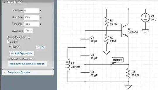

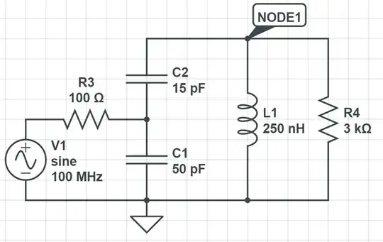

The oscillation happens at the frequency where the total phase shift of the amplifier and feedback circuit is exactly 360 degrees or its multiple- including zero degrees. The amp does not in this case invert the phase, but heavy capacitive load causes phase lag - tens of degrees. But the phase shift of the LC circuit cancels it and that happens near the resonant frequency of the LC circuit because the phase shift there depends steeply on the frequency. The resonance boosts voltage, so all what's needed for oscillation exist. It can be explored by simulating:
I guessed the output impedance of the emitter follower is 100 ohms and the total loading resistances of the LC circuit is 3 kOhm. The simulator didn't hit just the 0 degrees phase shift point, but quite near. We have a good reason to believe that there's some voltage boost at the 0-degrees total phase shift frequency.
BTW if a series of L and C is connected to a signal source which outputs near the resonant frequency signal, the voltages over the inductor and over the capacitor are higher than the output of the signal source assuming that there's not too much losses nor resistive loading. One can prove this easily with the common complex phasor calculus.
More exact simulation is possible by changing the emitter follower amp circuit in the place of my 100 Ohm resistor. The right transistor and the right DC biasing of it are important, because rf properties of transistors must be taken into the account in frequencies as low as 100MHz.

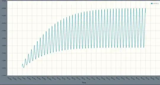

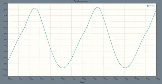

If one simulates in transient analysis mode the circuit with closed feedback loop he can see the oscillating frequency. It's as accurate as the part models in the simulation. We try it now:
It oscillates, but the waveform is not so clean sine. That's because the oscillation amplitude grows as high as possible until the amp starts to distort badly. Better sine needs some more clever amplitude stabilization than distortion.
The frequency is about 91 MHz. It's 3MHz less than predicted in the idealized phase shift estimation. It's caused by the capacitance of the transistor and probably by the not so perfect guess of the output impedance of the amp. In addition the distortion in the amp makes all on linearity based things (for ex. the output impedance -concept) more or less false.
The oscillation frequency could be approximately calculated. As said, it's near the resonant frequency of the LC circuit.

  • I am not at all sure there's a problem in Multisim. I analyzed only a narrow frequency range (=50...150MHz) with dense frequency sampling to get a plot which is not too coarse. There's about 100 frequency points. Wit default settings the plot would be far too sparse. –  Jan 16 '22 at 18:33
  • The only Colpitts oscillator I get to oscillate in Multisim is the most basic type of CE oscillator. CB or CC don't work. I tried transient of CB amplifier in CircuitLab, and I at least got sine wave until my trial expired. – Pavle Hribar Jan 16 '22 at 21:09
    @PavleHribar I inserted the images of time domain simulation to the answer. Skipping the initial (=searching the operating point) reduces the needed simulation time substantially. –  Jan 16 '22 at 22:43
