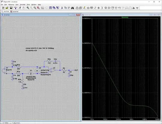

Finding/calculating the individual noise gains can be time-consuming. It is much easier/faster to do a little noise simulation, e.g. in LTspice:
From this noise simulation, the total voltage noise density is approximately \$1~\mathrm{uV}/\sqrt{\mathrm{Hz}}\$ at \$1~\mathrm{kHz}\$, \$100~\mathrm{nV}/\sqrt{\mathrm{Hz}}\$ at \$10~\mathrm{kHz}\$, and so on.
