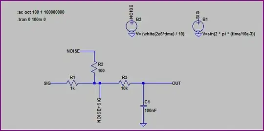

Yes, you can inject noise using the arbitrary voltage (or current) source, then use things like the random or white function to create some noise.
Here is an example circuit (I separated the noise from the signal just to make things clearer - obviously you can combine them together in one function if you wish):
Noise Circuit
Simulation:
Noise Circuit Simulation
All the functions are detailed in the help under circuit elements -> arbitrary behavioral voltage or current sources.

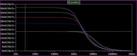

Noise simulation mode
Also, just in case you were not aware, SPICE has a noise simulation mode, to quote from the help files:
.NOISE -- Perform a Noise Analysis
This is a frequency domain analysis that computes the noise due to
Johnson, shot and flicker noise. The output data is noise spectral
density per unit square root bandwidth.
Syntax: .noise V(<out>[,<ref>]) <src> <oct, dec, lin> <Nsteps> <StartFreq> <EndFreq>
Basic example:
Noise mode
Simulation:
Noise mode sim
The above is rather boring as it only models the resistor noise (I stepped the resistor through various values to show how the Johnson noise increases with resistance). But it can be very useful with more complex circuits containing diodes/transistors/opamps/etc.
