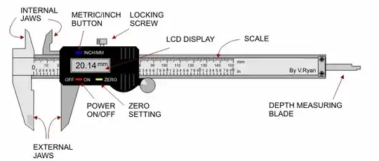

Vernier calipers can be used to measure both the inside diameter (i.d.) and outside diameter (o.d.). This works if you have only the device (receptacle) or the supply (plug).
enter image description here (Photo courtesy technologystudent.com.)

    LOVE the animated caliper... :) I've got one that measures us to 2.5", but the jaws are still too beefy to get inside the hole to measure pin diameter. There's about 3-4mm before the pin is accessible; the slope of the jaws just don't do it. In most cases, the hole is easy with the internal jaws...the pin seems to be a bigger issue. Maybe I'll get a cheap Chinese caliper on eBay and spend an afternoon Dremel-ing the jaws... :) – dwwilson66 Mar 03 '13 at 04:44
    I'd recommend using the internal jaws to estimate the o.d. of the pin. helloworld922 is spot on - there are only a few pin sizes per barrel o.d., so if you can estimate by eyeballing with your caliper, you can almost always pick the right one. – HikeOnPast Mar 03 '13 at 05:02

    Sorry, but this is Just Plain Wrong. A caliper will correctly measure the inside distance between two flat surfaces but will not correctly measure the inside diameter of a round hole. It will always give an undersized measurement. As suggested in other answers, PIN gauges, or faking a PIN gauge with drill bits, will give a much closer answer. If your hole is large enough you can use a "small hole gauge" (look that up too when you look up vernier) in conjunction with you caliper or micrometer, but you cannot expect a direct caliper measurement to be correct. – MickeyfAgain_BeforeExitOfSO May 05 '14 at 01:01
    A caliper will tell the inside diameter close enough to determine pin size of a barrel jack. You rotate the caliper while pulling it apart until it stop growing. – Joe Sep 13 '14 at 15:22
  • Actually, the jack has the pin, it's the plug which has the socket. So if trying to purchase a supply for a device, it's an OD measurement which is being made (the overall barrel diameter is larger, so making that ID measurement is more practical) – Chris Stratton Jan 01 '15 at 04:59
    Not helpful -- yes you can measure the hole, but how do you measure the PIN!? -- you can't get either set of jaws in there to clamp on the pin to measure it. – BrainSlugs83 Jul 04 '15 at 09:01

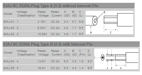

Source: https://www.accesscomms.com.au/eiaj-rc-5320a-plugs
EIAJ RC-5320A Plugs
EIAJ is an acronym for Electronics Industries Association of Japan. EIAJ have now merged with the Japan Electronic Industry Development Association (JEIDA) to form the Japan Electronics and Information Technology Industries Association (JEITA). EIAJ developed a range of plugs and jacks for connection of low voltage power supplies to consumer equipment. EIAJ plugs have now been widely adopted by Japanese and other consumer product manufacturers. EIAJ Plugs are similar in design to more commonly used Concentric Barrel Plugs. They can usually be identified by a yellow coloured insulating ring at the tip. EIAJ RC-5320A plugs are available in sizes to suit five Voltage Classifications. EIAJ Type A (1, 2 and 3) have a hollow centre similar to the Concentric Barrel Plugs. EIAJ Type B (4 and 5) have an internal pin. The EIAJ standard requires that these plugs are always wired with the centre pin as positive (+) polarity.

  • Although just a link to outside source, this answer was actually the most helpful. – Nakedible Jul 15 '14 at 06:33
  • @Nakedible, I agree. Didn't realize what I have isn't just a "concentric Barrel Plug". Also the yellow tipped connectors seem pretty common. – freb Nov 25 '15 at 02:12
