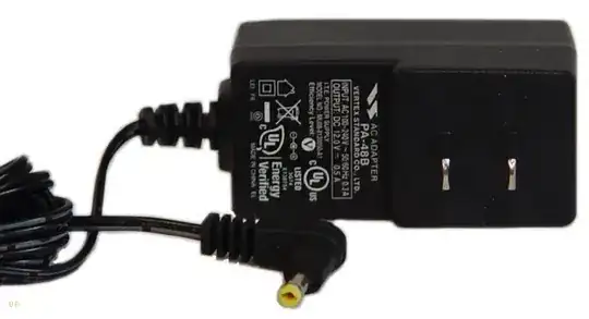

No. The VX-8R series radios require 11-14 V DC (Negative Ground, EXT DC jack) input to charge ("Operating with Charging" pg 166 of the Operating Manual). Take note of the PA-48B charger: PA-48B Vertex Standard Co 12V AC adapter for Yaesu Radio
