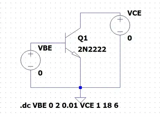

Let us assume that we have an NPN BJT sitting on the following circuit, drawn by LTSPICE: enter image description here

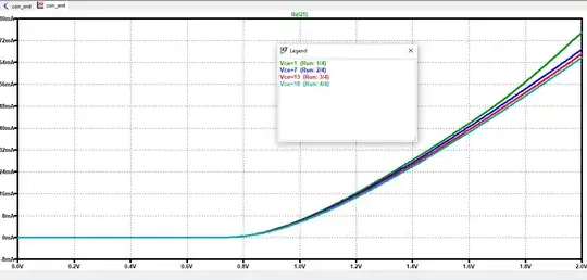

For the given dc sweeps we get base current versus V_BE for different V_CE values as below: enter image description here As we see for a fixed V_BE, increasing the V_ce will drop the base current. Qualitatively (no formula used) why this happens? I say when we increase the V_CE more electrons will be drifted to collector so I_C should go up and I_B is linearly go up as I_C going up since there is a beta coefficient relationship between base and collector currents. Where am I wrong in my reasoning?

The Base current in the NPN BJT has two components.
  1. The 1st component is due to the diffusion of holes from the base (p region) to the emitter (n region).
  2. The 2nd base current component is the one supplied by the external circuit to replace the holes lost by the recombination of the electrons already diffused from the n (emitter region). This current depends on the total minority charges (electrons from the emitter diffused to the thin base) in the base region. Since the total minority charges will increase linearly by the effective base width (which is the physical base width without the depletion regions), this 2nd base current component is linearly dependent on the effective base width.
Heart of the reasoning: As the V_CE increases the depletion region between base and collector grows making the effective base width narrower makes the 2nd component of base current smaller and the 1st component of the base current remains unchanged. Therefore increasing V_CE will narrow down the effective base width decreasing the base current as seen by LTSPICE simulation too.

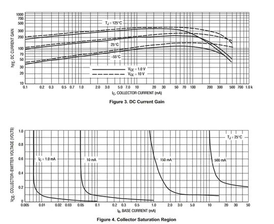

You are neglecting power dissipation in this unrealistic test and for your region of concern the transistor would be burning up.
I cannot vouch for the LTspice model accuracy, but from datasheets for 2222A types;
Vce Saturation (Max) = 1V @ 50mA, 500mA which dissipates 500mW which is far too much. Thus, Vce= 7V, 13V, 18V would not be possible in saturation.
Consider the PN2222A Rce is very good ( 1~2 Ohms @ Ic=10 mA) and Rbe you have shown reduces to ~ 17 Ohms.
That makes this hypothetical question a bit irrelevant. Also consider BJT's are Ic vs Vbe (not Ib vs Vce)
ref
https://media.digikey.com/pdf/Data%20Sheets/ON%20Semiconductor%20PDFs/MPS2222%20&%202222A.pdf
From above datasheet the saturation effects you can see for a nominal part Ic=500 mA, Ib=50 , Vce = 200 mV implies Rce=0.2/0.5 = 500 mohms @ 500 mA and 100mV/150mA= 667 mohms .
This causes the hFE to drop faster at high currents and Vce=1.0V due to the Rce effects in saturation, which does not occur at Vce=10 (dashed line plot) since that is not saturated.
