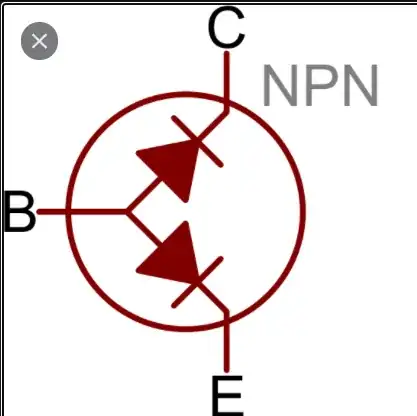

I don't understand how we can model an NPN transistor with two diodes with their anodes connected. Shouldn't they be in series, with the base being in-between the diodes? An NPN transistor is in active mode when the base has a higher potential then the emitter and when the collector is at a higher potential than the collector. Having them in series makes much more sense. If the anodes are connected then the collector potential would have to be so much higher than the base to conduct in the wrong direction.

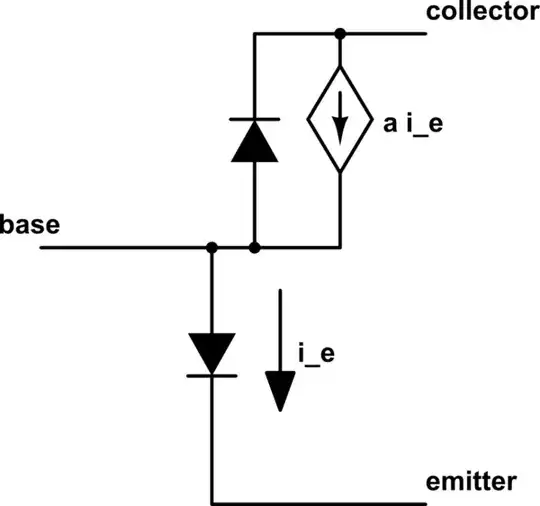

A much much more accurate model, if you know what a dependent source is, is the Ebers-Moll model -- I've included one for a transistor that's in a normal forward-bias condition (collector voltage much higher than the base, base voltage higher or equal to the emitter voltage). The two diodes are as your model above, but the dependent current source (the diamond) shows where the emitter current generates a collector current.
