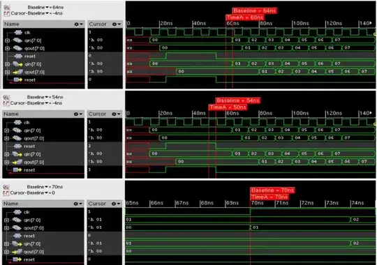

And this is the waveform:
I can see the #4ns skew for outputs, but I cannot see the #1step skew for the input.
What's wrong?

There is nothing wrong; the simulation behaves as expected. The clocking block applies the 4ns delay to the output as expected and as seen in your waves.
However, the clocking block does not apply any delay to the input. The clocking block samples the input before the rising clock edge. Refer to IEEE Std 1800-2017, section 14.4 Input and output skews:
Input (or inout) signals are sampled at the designated clock event. If an input skew is specified, then the signal is sampled at skew time units before the clock event. Similarly, output (or inout) signals are driven skew simulation time units after the corresponding clock event.
Since you specified 1step, the input is sampled 100ps before the rising edge of the clock. One step is equal to the timeprecision. The sampling point will not be visible in the waveforms since it is not a separate signal.
