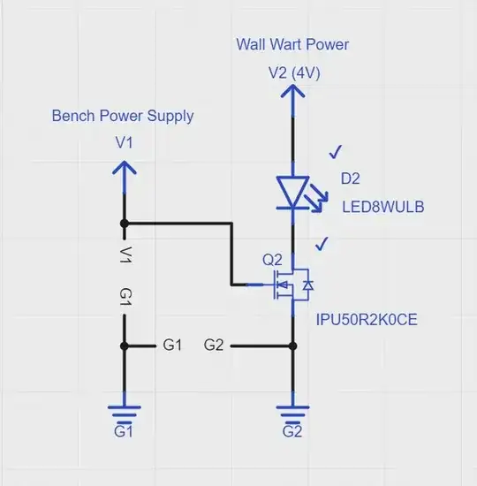

Iteration 1: No resistors. According to my circular perception, this shouldn't work since electricity won't flow from V1 into the gate without a return path. To my surprise, after the circuit is assembled but w/o power, providing power to V2 but not V1 (e.g. power supply off) the led would flicker unpredictably. I had read that MOSFETs gates can hold a slight charge and that MOSFETs can also have very slight leakage so I chalked this up to operating the MOSFET in an undefined/unpredictable parameter space and moved on.

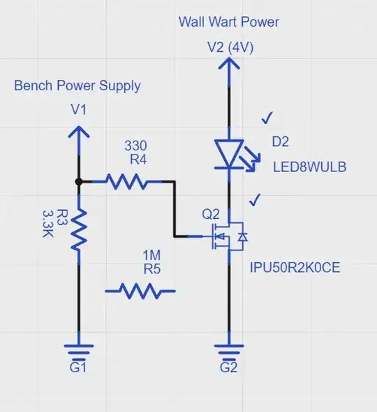

Iteration 2: Try to add resistors between gate and V1 kind of blindly following schematics such as the one here ( Question about mosfet gate resistor) . It more or less produced the same result, unpredictable flickering.

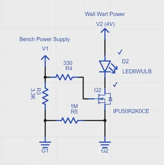

Iteration 3: Reasoning that I still wasn't closing the circle for the electricity flowing into the gate, I added a very high resistor between source and GND2 (The first/FINAL schematic). This works exactly as I wanted it to. With bench supply at 1A. At 0V, LED is off. At 3V, LED is on. At 4V+ LED flickers. I'm looking into this and whether it's a result of Vg > Vd (For example, learning about source-follower configuration and whether it applies for my transistor; It's not essential that I understand the ins and outs of this at this moment).
This toy example provides the necessary tool for me to join low voltage low current logic circuits to high voltage high current flow/load circuits. Unfortunately, I'm still at a loss as to why it works and under what parameters. Just beyond the source pin, it would seem that I am encountering electricity from both circuits. How do I dictate what electricity returns to GND1 via R5 and what electricity returns to GND2? Currently it doesn't seem to matter because I'm using low voltage low current on both sides. However, I need my understanding to increase so that in the high voltage high current flow/load circuit case, I don't overwhelm the GND1 return path or the resistor R5.

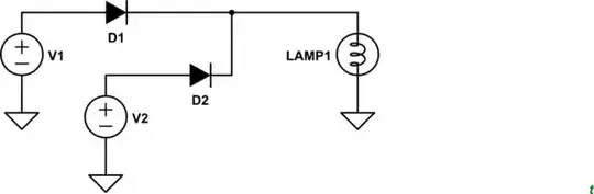

... OR-ing a second power source with a Schottky diode.
This is fairly common.
schematic
Figure 1. OR connected power supplies. Whichever supply has the higher voltage will power the lamp.
Usually "back-powering" or backfeeding would describe where, for example, V2 > V1 and tries to push current into V1. The diodes prevent this. (Current will only flow in the direction of the diode arrow.)
