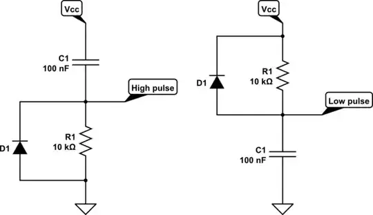

You could use a small RC pair to provide a signal that stays high or low for a short time after power on:
schematic
D1 solves your problem of the capacitor remaining charged after power off, but probably isn't necessary, as the input protection diodes on most CMOS device inputs would perform the same function.
As to how to use this with an SR latch, here's a hint (since you don't want the full solution): You don't have to use a 2-input gates.

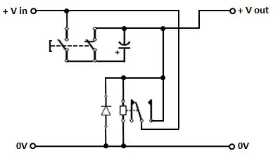

Here's a circuit utilizing an electromagnetic relay.
