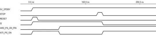

EDIT:
Pardon the timestamps; they're not accurate, and I don't know how to turn them off on the app I downloaded. First, the user turns on the physical switch on the back of the ATX power supply, thus turning on 5V_STDBY but not main +5/+12. ATX_PS_ON has a pullup resistor; as long as it's high, main power is off, so ATX_PS_ON goes high at this time.
I want the latch to power up with Q' high, so I want to bring RESET high briefly. Since 5V_STDBY powers the latch, I want RESET to still be high once 5V_STDBY stabilizes so the latch gets a good start state, and to the best of my knowledge, I can't predict how long that will take because I don't know how 5V_STDBY is loaded (correct me if I'm wrong).
Sometime later, possibly many minutes, the microcontroller will bring ARD_PS_ON_PIN high to turn on main power for the rest of the robotics. It will leave it there forever.
If subsequently the sensors detect a bad state, they will bring the STOP pin high, maybe only briefly. This brings Q' low, ATX_PS_ON high, and turns off main power, until the power supply is power-cycled.
The main question is how to either get that behavior on the RESET line, or design my latch not to need it. I feel that I must be making a hash of this: powering up latches and even gates in a known state is something every logic IC since the beginning of time has had to do, so there must be best practices.

  • I can't seem to wrap my head around all of your requirements as they relate to time. Could you post a timing diagram, please? – EM Fields Nov 21 '14 at 06:55
