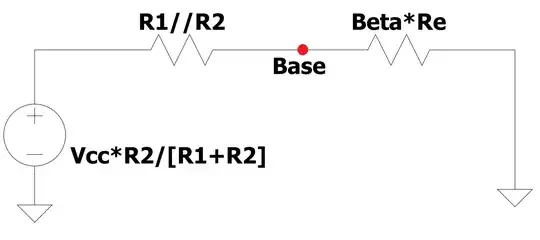

Approach 1:
This approach is author's idea and the result is R1 = R2 = 100k (you can see author's calculations in the page above.) I understand this approach. The author uses an equivalent circuit using Thevenin's theorem:
In order to have base voltage close to source voltage Vcc*R2/(R1+R2), the Beta*Re should be ten times larger than (R1||R2) resistance. I understand this idea well.
Approach 2:
This is another approach. The idea is to make the current going through R1 and R2 ten times larger than the base current (I understand the idea too.) Now let's calculate it:
Ib = Ie/Beta = Ic/Beta = 1/100 = 0.01 mA
Then current goes through R1 and R2 should be: 10*Ib = 0.1 mA
We still have R1 = R2 = R, then Vcc/(2R) = 10/(2R) = 0.1 mA
So R1 = R2 = R = 50k, this result is half of Approach 1.
Why is that?

  • Either approach gives you an approximation of an answer. Remember β is a variable constant, as in, it is only constant within the region of the I_C vs V_CE being examined. – StainlessSteelRat Oct 25 '21 at 17:09
  • Two different approximations give two different results, because they are only approximations, and they have different starting point how to approximate based on different assumptions about the circuit. – Justme Oct 25 '21 at 17:14
  • @StainlessSteelRat I assume $\beta =100$ as using in the book in both approaches, what suprise is the results is doubled (or halved) – Dat Oct 25 '21 at 17:16
  • It gets you an answer. Different approach, different answer. Whether R1 and R2 are 100kΩ or 50kΩ. No real fundamental difference. A 2n3904 has a β which varies from 100 to 300, changes the Q-point anyway. It's an approximation, which gives you a Q-point. – StainlessSteelRat Oct 25 '21 at 17:22

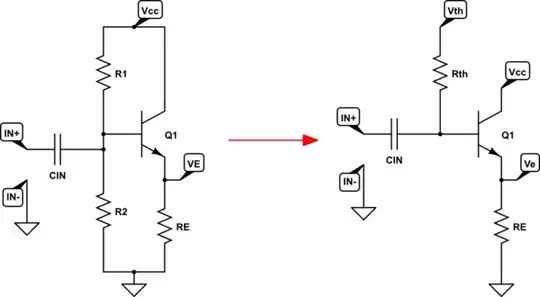

Let's simplify the schematic a little:
schematic
These are the same thing for analytical purposes (where \$V_{_\text{TH}}=V_{_\text{CC}}\frac{R_2}{R_1+R_2}\$ and \$R_{_\text{TH}}=\frac{R_1 R_2}{R_1+R_2}\$.)
What can we say, now?
  1. If \$R_{_\text{TH}}\to 0\:\Omega\$ then \$beta\$ variations of the BJT will have no impact on the biasing. That solves one problem. But the input signal will also now be ignored (attenuated to the point absence.) So we know going towards that extreme isn't useful.
  2. If \$R_{_\text{TH}}\to \infty\:\Omega\$ then the biasing pair no longer adds any attenuation to the signal (only the emitter load plays a role now.) But, of course, the base current will cause an infinite voltage drop across it and we know that's also not useful to consider.
So we can conclude that \$R_{_\text{TH}}\$ is finite and larger than zero and that there may be a range of values that are acceptable. Your choice says to set \$R_{_\text{TH}}\$ to a fixed relationship with nothing more than the BJT's design \$\beta\$ (let's call this \$\beta_{_0}\$ so that we can freely allow \$\beta\$ as a variable) and whatever emitter resistor value was chosen.
What makes for a good choice? That's the question. I'll leave that, for now, and move on to a point I wanted to make in chat with you but where I cannot display math there.
The main point of the NPN emitter follower is to retain most of the signal while taking advantage of the BJT's \$\beta\$ to significantly boost its active output current sourcing compliance. (It's sinking compliance will be determined by the passive emitter resistor component.)
In both my suggestion as well as the book's, we find that we share the idea that \$V_{_\text{B}} = V_{\!_\text{CC}}\cdot\frac{R_2}{R_1+R_2}\$. No disagreement there. Obviously not, because this relationship is not subject to opinion. It's fact.
The only remaining question, which is subject to opinion, is whether to use my preference of \$\frac{V_{_{\text{E}_0}}+V_{_\text{BE}}}{R_2}=10\frac1{\beta_{_0}+1}\frac{V_{_{\text{E}_0}}}{R_{_{\text{E}}}}\$, which ensures \$R_2\$ carries a residual current that is 10 times the BJT base's recombination current.
(Note: here I'm using \$\beta_{_0}\$ and \$V_{_{\text{E}_0}}\$ as design input values.)
Or to use your thinking, as I gather it, of \$\frac{R_1 R_2}{R_1+R_2}=\frac{1}{10} \beta_{_0} R_{_\text{E}}\$.
The solutions to these two cases are:
$$\begin{array}{r|c:c} \hline K=\frac{\beta_{_0}R_{_\text{E}}}{10}& \text{my approach} & \text{your approach}\\ \hline R_1&K\cdot\frac{V_{_\text{CC}}-V_{_{\text{E}_0}}-V_{_\text{BE}}}{V_{_{\text{E}_0}}} & K\cdot\frac{V_{_\text{CC}}}{V_{_{\text{E}_0}}+V_{_\text{BE}}}\vphantom{\frac{\frac{\frac{A}{B}}{B}}{\frac{A}{\frac{A}{B}}}}\\ \hline R_2 & K\cdot\frac{V_{_{\text{E}_0}}+V_{_\text{BE}}}{V_{_{\text{E}_0}}} & K\cdot\frac{V_{_\text{CC}}}{V_{_\text{CC}}-V_{_{\text{E}_0}}-V_{_\text{BE}}}\vphantom{\frac{\frac{\frac{A}{B}}{B}}{\frac{A}{\frac{A}{B}}}}\\ \hline \end{array}$$
(Solution proof follows at end, below.)
Do you see, now, the interesting symmetry between your approach and mine? I mentioned in chat that there was an inherent inversion between the two. I also mentioned that the solution surface of your thoughts was very much at odds with the more viable solution surface I think is appropriate. In fact, your surface only nears the solution surface I see, along a specific line that is always halfway between the voltage rails and never quite touches. You can now certainly see what I saw before. And this is one or two of the three things that immediately told me your approach was wrong-minded.
I will leave it there. I just needed to set down the math and I can't do that in chat. We can continue the textual part of the discussion there, using the above as an illustration to help.
